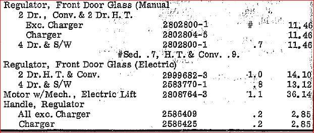

I can't seem to find a door window regulator for my 66 charger. The vendors have them for B body's. But state not for charger. Question, Will the regulators for a 66 - 67 coronet fit my 66 charger? Thanks.

The window regulator for a Coronet has a shorter crank shaft as the Charger longer as it has a much more padded door panel. There is almost no thickness to the Coronet one. That is the major difference in window regulators.
If you have an electric, they should be the same.
