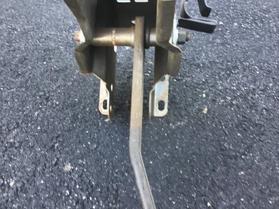

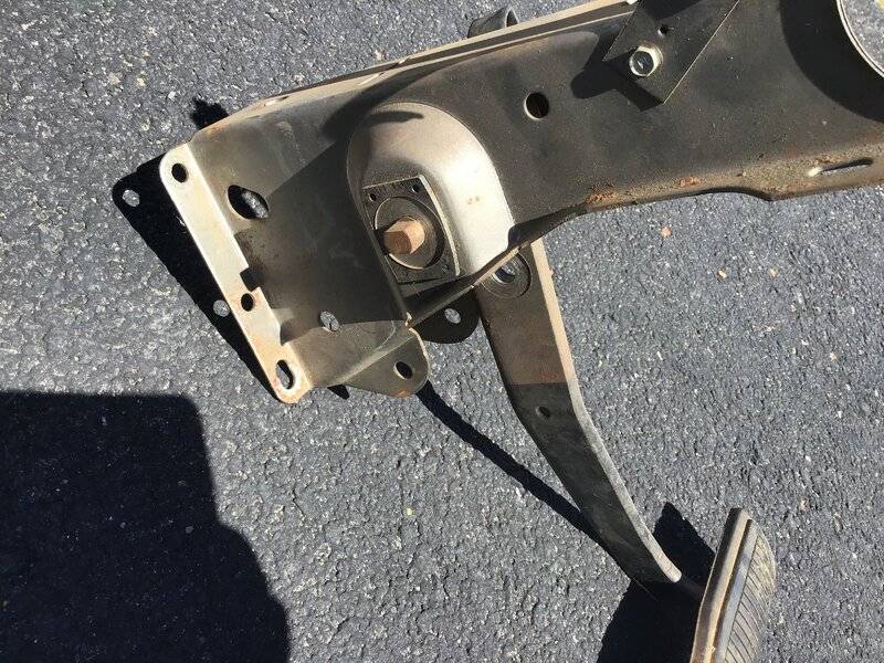

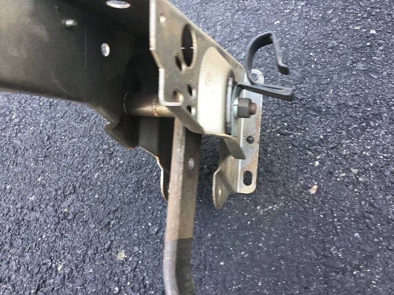

Here is a picture of a 67 brake pedal, has a nut on passenger side of pivot. Might be hard to get to under the dash. The pedal should swing freely. Please let us know what’s inside there bushings or bearings.

The nut came off, but nothing else yet. It seems to be a puzzle.
