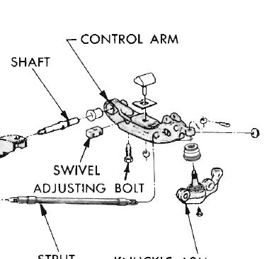

Adjust or replace the torsion bars.
On lower there's a bolt you tighten to raise front end. If make any adjustments have front tire off the ground. Count how many turns you tighten bolt, both sides same number of turns. Then have front end aligned and tell tech what you did so he doesn't undo your work. Service Manuals – MyMopar
The bolt is the adjuster.
Before you make adjustments, check your lower control arm bushings. Good advice above.
Wire brush first, then Spray lube and soak before turning the bolts. Do this from the bottom side and you will be turning them clockwise to go up. Try 6 turns to start. Bounce and roll car To check height.
