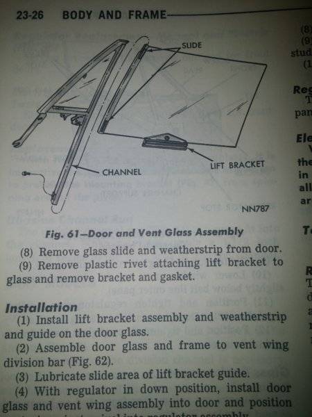

I have come to my door windows for my 66 Coronet and realize I don't have any pics of them as they were removed. I see two holes in the glass at the front edge that appear to have had some form of guide in them. I also don't have any weather strip in the vent rails. Does anybody have a picture of the pieces I'm needing to find for my windows? I may have the parts somewhere, but I can't find them.

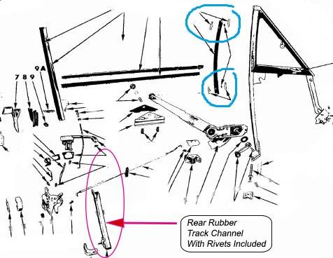

Those 2 holes get a plastic H like piece that rides in the vent window track felt. They are just like the 68 69 setup I think. Someone may correct me on that.
I have them circled in blue on this picture. And this link will get you all of those pieces new if you are missing them. http://www.partsmix.com/categories/b-body/window-regulators-rollers-etc.html
They are the same from these years.
MOPAR 1967-74 A-BODY, 1966-70 B-BODY, VENT WINDOW CHANNEL (PAIR)
Thank you guys. I think I may have broken the clips as I don't recall this part of disassembling the car. Doh. But I'm going to go search my boxes and shelves now!
I have all of my door window parts in big boxes that have been taped shut since the parts came off. Cant wait to try figuring out how it all goes together, but that's what the manual is for. Great link too by the way, thanks!
