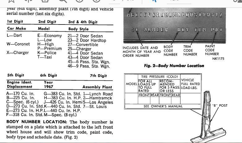

If theres a chance yours may not be all factory post the date on the lower control arms as well if avail
EDIT , Build plant the car was produced as well would be beneficial as well , just in case

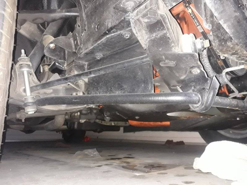

pc is my car . And Im pretty sure its the original front suspension
I'll go first
1966 Satellite, hemi Auto, SBD is April 5th 1966 Lynch rd plant
Mine has the later style.
And there are no dates on the lower control arm rivet
