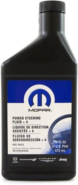

Hello everyone, I am currently working on a 1966 Plymouth Satelite 5.2L 318cid V8. My father-in-law had a power steering unit add on. I am trying to figure out what is the best type of fluid to use. Any information would be greatly appreciated. Thank you in advance.
I usally just put in the stuff that says "Powe steering Fluid" on the bottle.
Just plain parts store power steering fluid.
You should leave the line off the box at first flush it briefly.
Connect that line then flush through the return line to a container.
Connect the return line.
Finally fill and turn the wheel fully one way, then the other a couple times.
