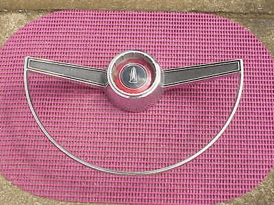

My horn ring is just like this one.
The full ring has nothing to do with the center cap, it just completes the outer circle. The actual cap itself should be the same. You will have to remove the plastic center from your cap and install this plastic insert. A picture of your cap should help.

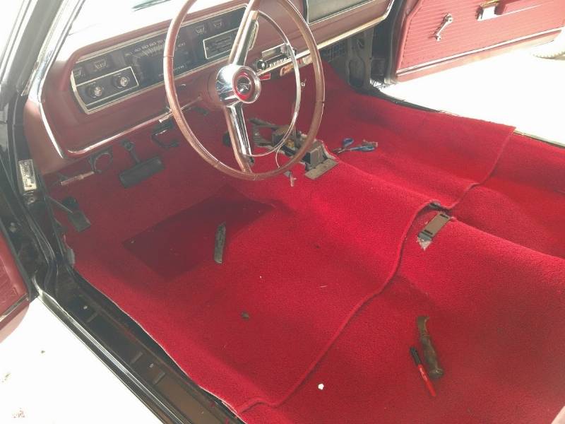

My car has this exact same partial ring.
The ebay seller days the center ornament he has is for the full ring only.
So am trying to find out if this center will work in mine
No....looks like he's right. They are different. Here's the full ring style, part # 2530965;
https://greatlakesmoparnos.com/shop/model/belvedere/1966-plymouth-fury-belvedere-steering-wheel-horn-cap-emblem-2530965/
The one you need is part # 25305253.
Now, that being said, those two parts are called the "Ornament, horn" in the parts books. The little red plastic insert with the plymouth marque on it, is not a separate service part and never has been as far as I know. So, both ornaments may very well use the same insert.... I don't know.

Just an update. the NOS center cap fits perfect in my partial ring
That definitely looks great on your car, but I wasn't talking about the half circle horn ring like you have on your car. I was talking about the 1965 and 1966 optional higher upgrade to the full circle chrome horn ring and they definitely take a separate chrome horn button that has the same plastic Plymouth center emblem as the half horn ring does.
