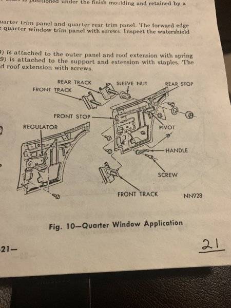

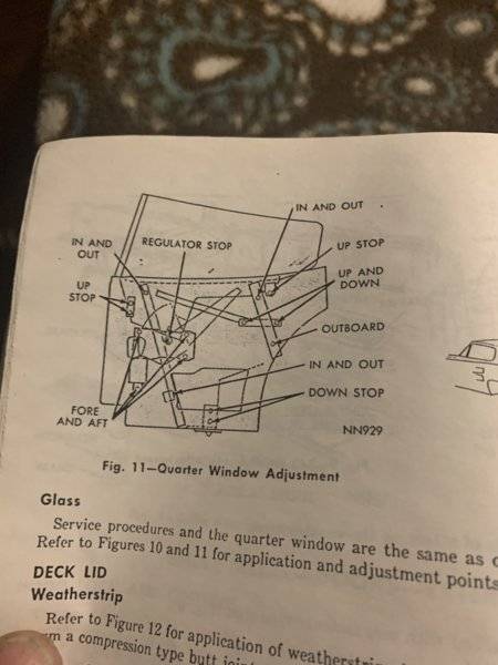

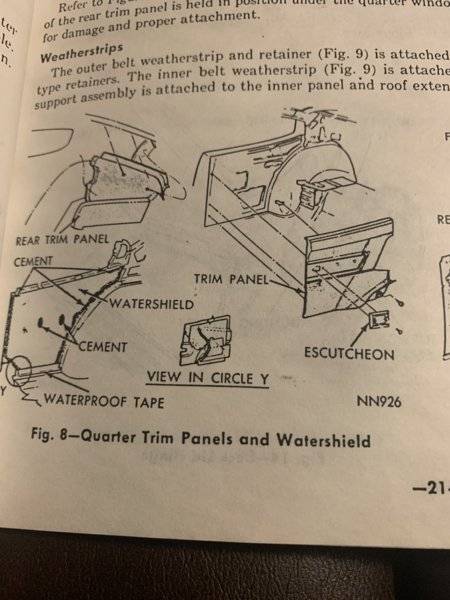

I have the books at work in regards to the tools and updates on what was used .
I pretty sure I have most from the late 50s into the early 70s. Ill scoop the ones of interest for here.
Ok
