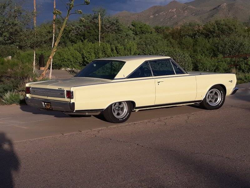

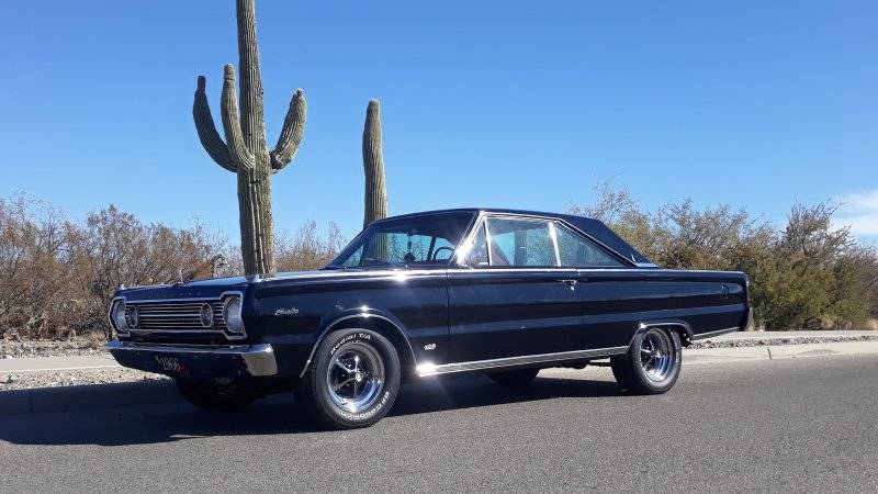

15x7 torque thrusts
Here's mine. 15x7 on the back and 15x6 on the front.

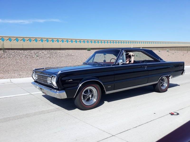

I've always thought Magnums suit these cars more than anything else.
Mine on 14's
What size are those BFGs in the first photo? Also, do you know the back space on those 15x7 torque thrusts?
Tires all the way around are 245-60-15. And to big IMO for how low the car sits. especially the fronts. They would rub pretty good on full turns
rears would rub up in the wheelhouse on hard bumps
I've since downsize the fronts to a 215-65-15 and no more issues.
Rears I've added coil over shocks to aleviate with the jounce and rebound bumps
Wheel backspace, I have no idea.

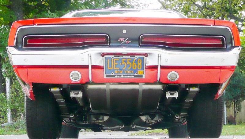

Would love to see some Keystone Classics on one of these.
Took the rear wheels off the other day on my '67 GTX and even with puny 215/70/15's I needed a shoe horn to get them off.
Miss my 295/50's I was able to have on my 69 Charger with room to spare!

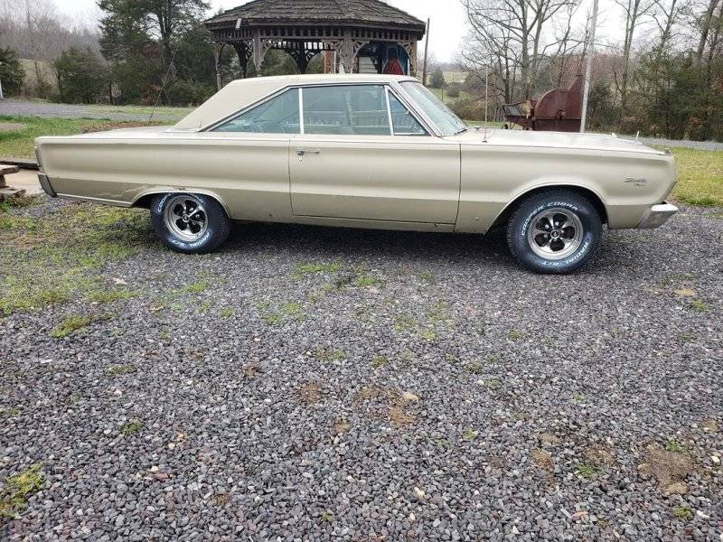

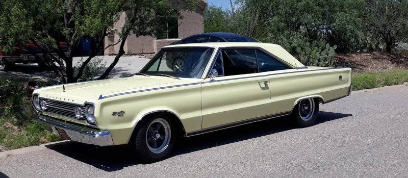

Chris a buddy of mine has a 66 Satellite in ZZ1 gold. And he has already bought a set of 15x7 Keystone Classics for it
But he is thinking early next year before its on the road
His is the one with steel wheels
the other is His goal is his goal picture he sent me of what he wants his to look like

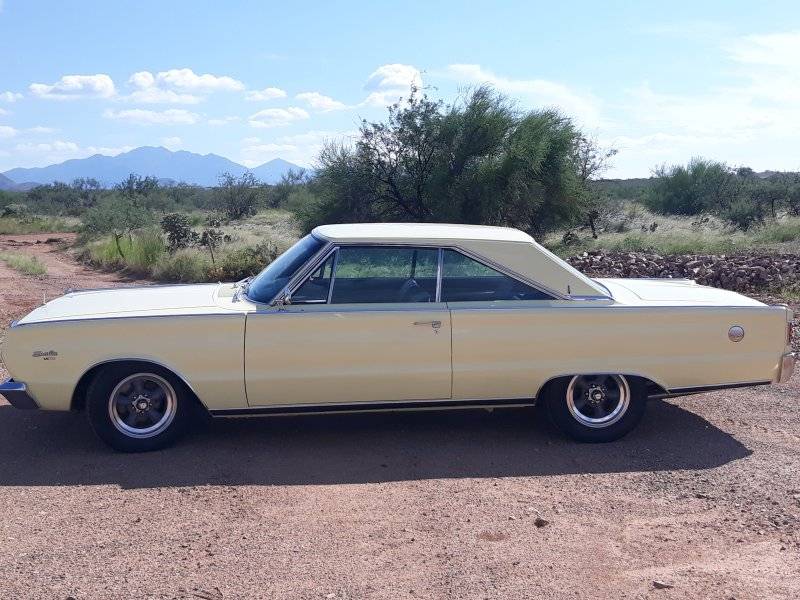

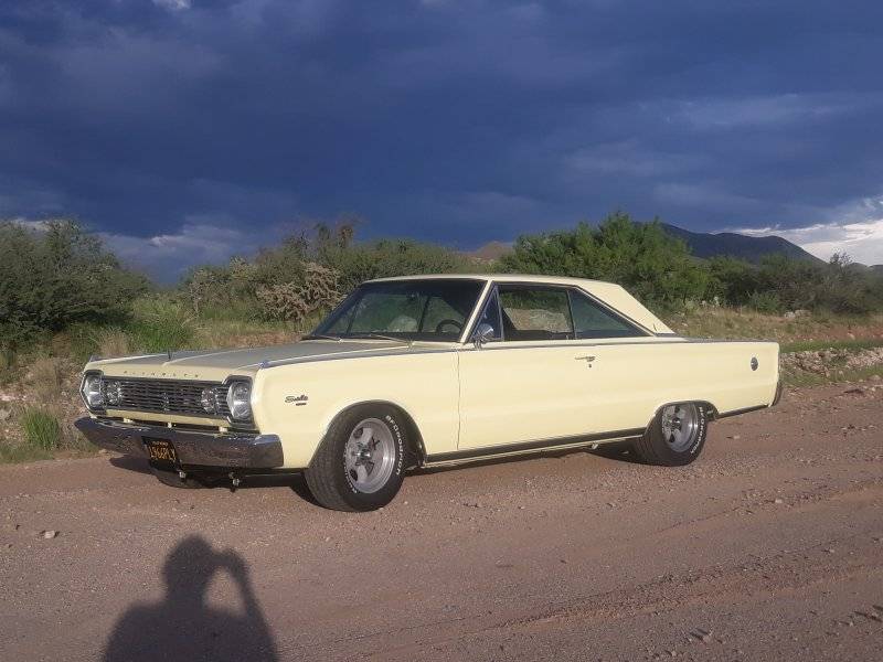

Here is mine on a set of polished knock off 17"TT's and a set of US mags 17/18
Those look great! What are the specs on both those combos? (Tire size, backspacing etc)
First pic has 215/60/17 on the front on 7" wheels with 3.75 BS. Rears are 255/50/17 on 9" wide with a 4.75 BS. (Tight to inner fender) 2nd pic has 17x7 3.75BS and 225/45/17 fronts and 245/45/18 with 4.5 BS on the rear.
