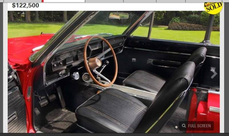

You could get factory PW's. PDL's don't know. Saw a 66 Hemi Sat vert with PW at an auction in Albany. NY.. Picture is from a Mecum auction around 2017. You can see switches on doors
