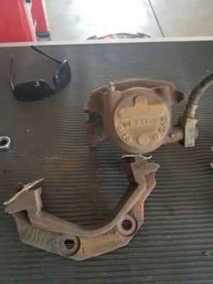

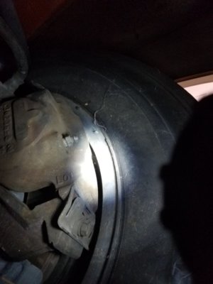

The car was a roller when purchased. The previous owner rebuilt the front end and installed
used spinals, I think off a Cordoba and not sure. Anyways I install the rotors (single piston) that came with the car and they fit nice with 14" steel wheels. I have around 1/4" clearance from the out side of the rotor to the inside of the wheel. No rubbing.

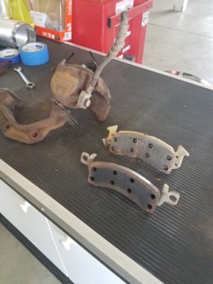

The pads I think are the wrong ones as I cant figure it out...no way to work.
Can some one identify from the picture what these rotors are off...like to purchase the correct pads.
20190625_130152.jpg 20190625_130200.jpg 20190625_123440.jpg 20190625_123459.jpg
The pad with holes looks like its for pin type calipers.
Great....pads for 73-76 A body, What is a F body?
Just thumbing through Chrysler performance upgrade book and it states the same as your recommendation. thx

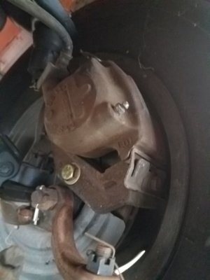

I believe your calipers are on the wrong side. The bleeder needs to be up top on the high side. Looks like your bleeders are low. Not gonna get the air out that way.....
Yeah that isn't going to work the way you have it bolted together. I'm not sure those calipers can be made to work on your car but at the minimum you have them on the wrong sides. Get them on the correct side of the car and then see if the brake hose will work. If the brake hose won't work then you'll either need custom hoses or different calipers.
I mocked them up with the brake line off the caliper to the frame mount/tap that connects to the additional line.
I will switch out and see how the brake line works. But that make total since about the bleeder.
I switched the calipers and works better. Don't know what I was thinking.

BTW the other pad in that pic looks like a slider pad
