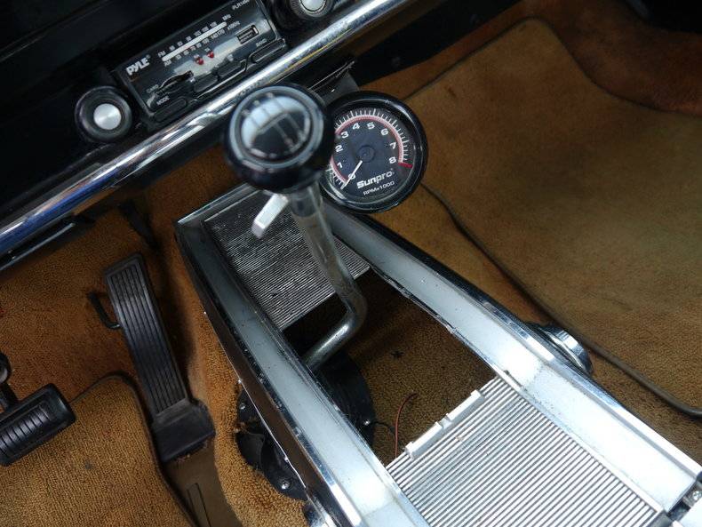

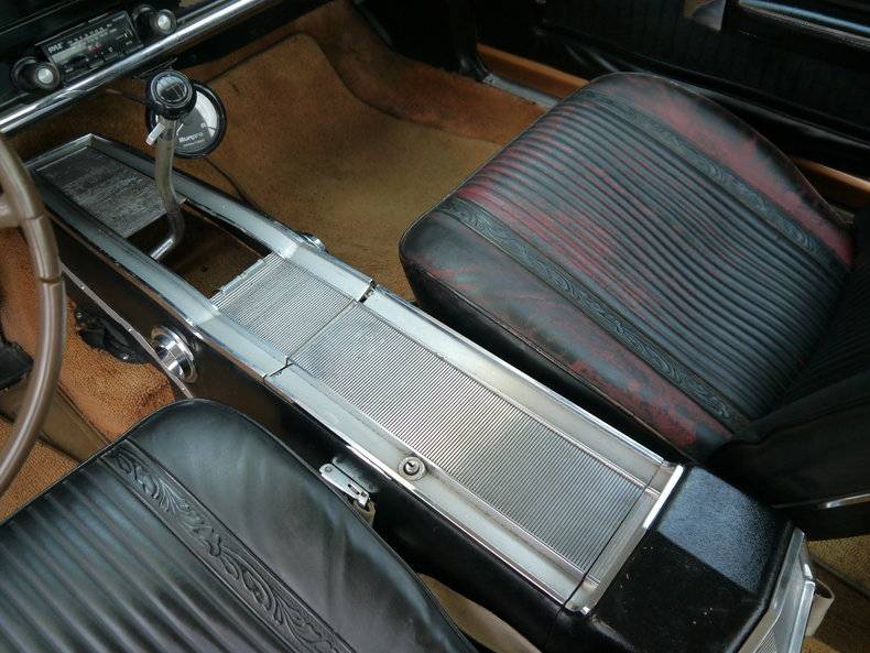

1966 Satellite is this a correct 4 speed console?
Paul_G
6:20 AM
Dec 24, 2013
2,091
3,329
Surprise, Arizona
This console just doesnt look right. Either it is just shoved in where it didnt belong, or peices are missing, or both. This car is for sale in Illinois.
http://mcecars.com/vehicles/540/1966-plymouth-satellite
It looks like a auto console with a cut out top plate. The left side trim piece on four speed console goes above the light.
I know 66 auto consoles (sticks I think) the part that beyond console door bolts on. The screws are inside console compartment on the back. Repo consoles are 67 and later consoles are one piece.

I think that car came with a gold interior. Probably had no seats at one time so somebody put in anything. Sprayed seats and dash black but not the steering column and left steering wheel and seat belts. Console looks like a cut up auto console.
It answered for me they had a brownish steering wheel with gold interior if you didn't order a 3 spoke wood grain wheel. My car I believe came with that steering wheel. Have a work order from dealer with steering wheel p/n for a wood grain wheel. Work was cose to delivery date.

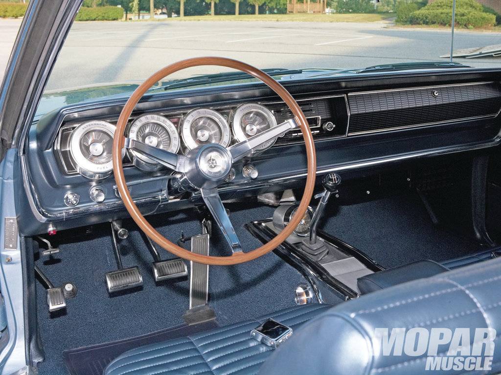

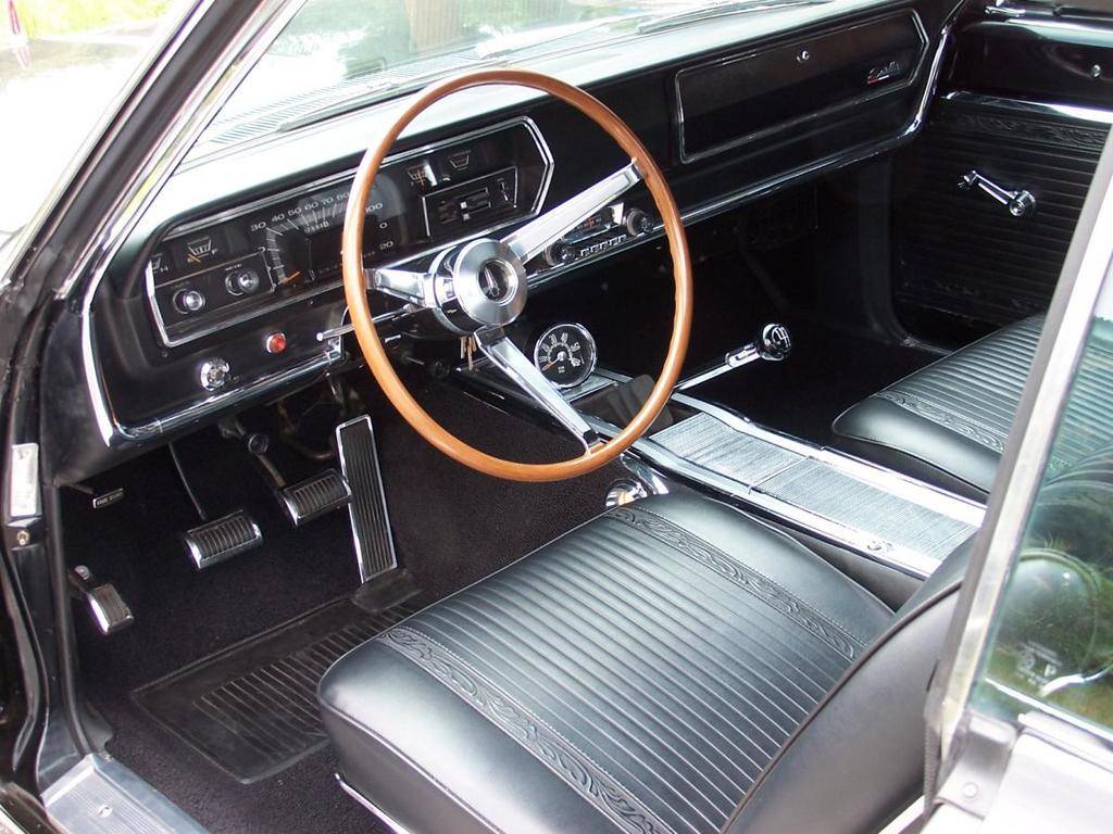

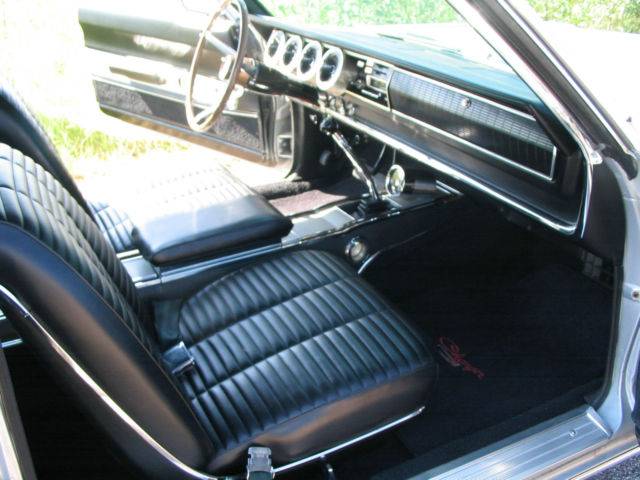

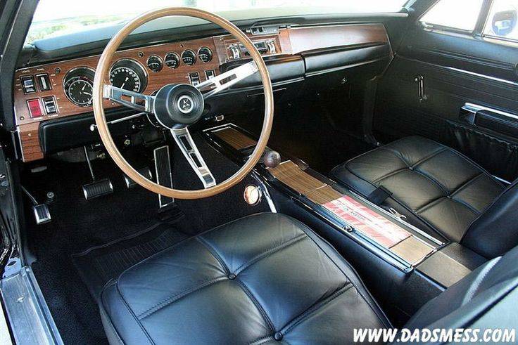

Missing the boot. Here are some pictures of other years but correct 4 speed.
