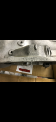

Just got a picture of the one that's for sale, looks like a 66 based on Nates posting.
Bad Picture - It reads as follows.
H2538389 2931475
Can anyone shed some light on the second set of numbers?
2538389 I Now know is a Hemi But what does the second set mean and is there a way to match it to a car?
I have two trans
1. H2538389 2931475
2. H2538389 3100442
There is no way to positively match a pre 68 trans to the car. The best you can do is have the correct part number for your application, and a casting date earlier than the scheduled production date of your car. I don't know what the numbers after the part number mean on a pre 68 trans. On a 68 up trans the first 4 digits are the 10,000 day calendar assembly date, and the second 4 are a daily sequence number.
