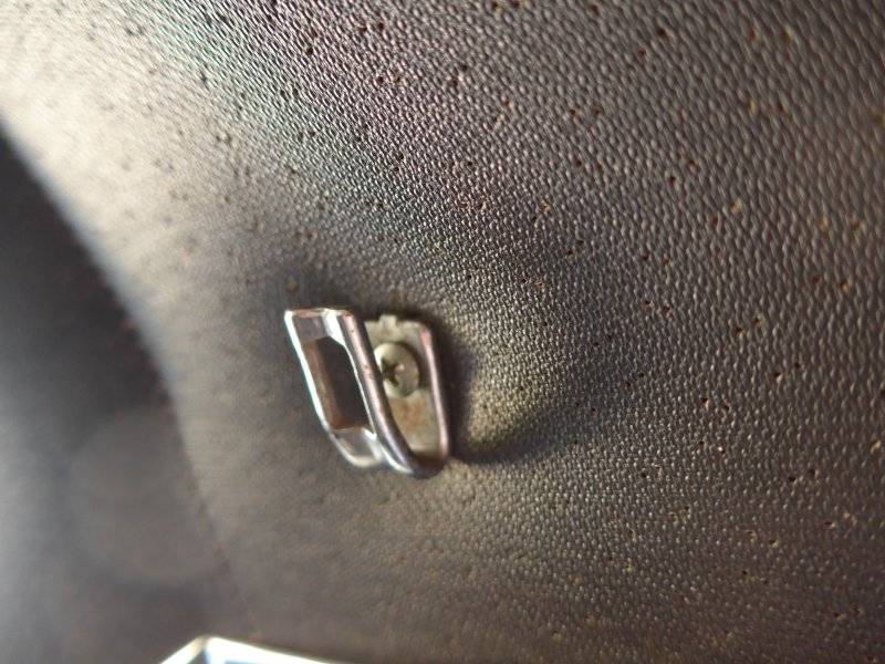

This is what mine looks like...

Assuming mine is "correct" - and I assume so as its a 47k mile car and reportedly has never been tampered with inside, i.e. all original interior - the screw hole is approximately 1 3/4 inch from the top of the moulding and 3 inches forward of where the trim moulding angles down.
Oh, and strangely, my car has only one, on the drivers side. never noticed before...
Yes that one looks correct. it is a 1967 only Item.
And drives side only is correct. If you hang something on the drives side the drive can still see just fine, but the pass side it will.d block the side view.
They are one year only.
