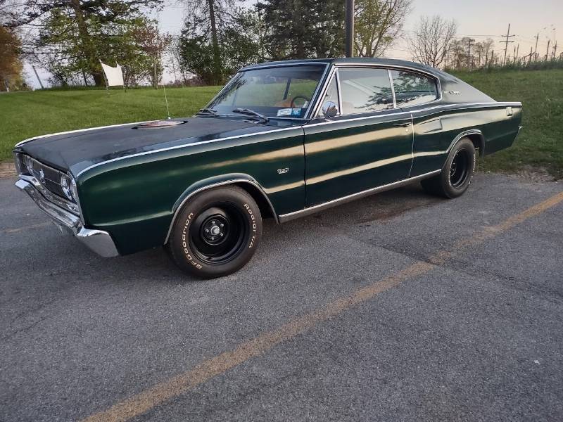

Hello all,
I have a 1967 Charger and it has rear factory suspension. I replace the front suspension.
Now I have a low rider, but speed bumps are like a wall to me.
I need to replace the rear leaf springs and then I can spin up the front torsion bars.
My issue: What is the actual fender wheel well height (Floor to upper trim) for the rear?
Trying to decide to replace with OEM or adding 1.5 inches of rise. But stumped as I have no measurement of what stock would be.
Tire size all the way around is: P225/70R14
Yep, All new drum brakes as well, Stops crazy fast.

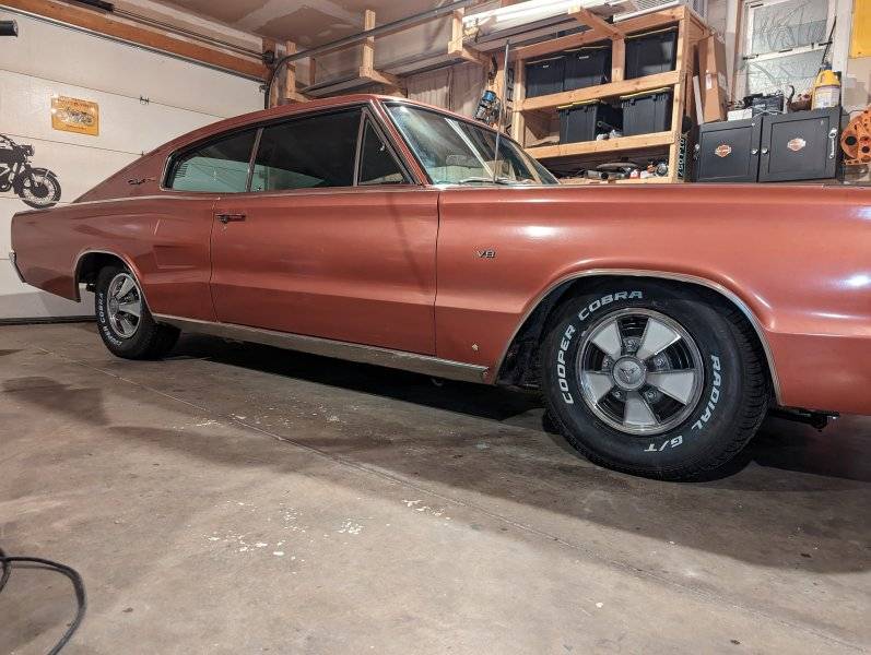

Sometimes just adding a leaf will do it. I ordered a set of springs through the Chrysler Dealer one time. Were not good, Dealer refunded my money and told me to do whatever I wanted with the springs I had a new set made. Will try to send pictures, 15 inch tires.
