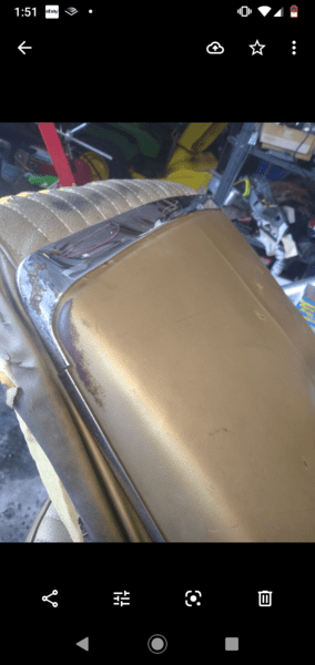

Does anyone make this color gold spray paint ? I thought I read that no one does yet
Also, my trim is rusted, anyone selling it the trim around here?
Here's the pic

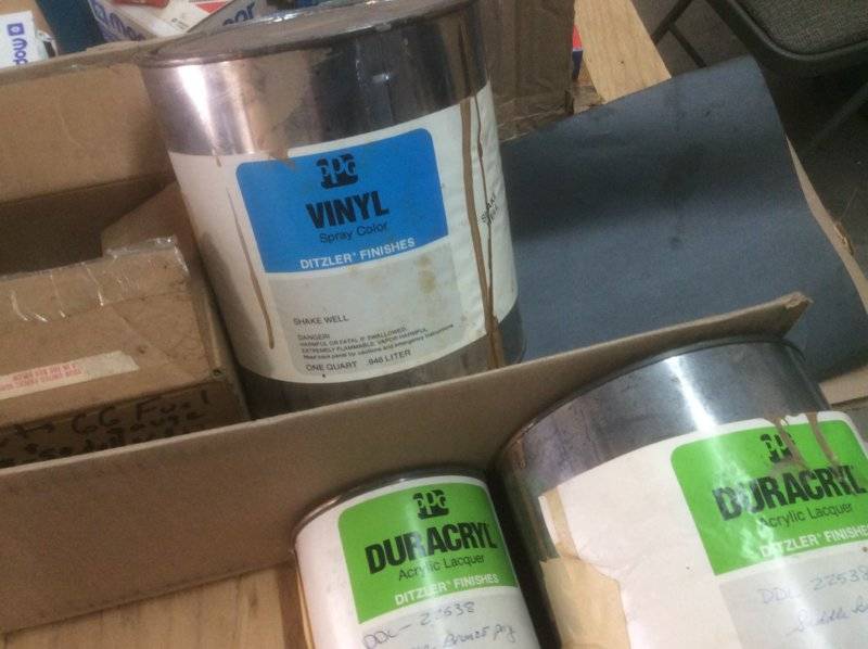

I dyed a black one gold. It has a grain as Jerry said and its not wrinkle finish. Might have the PPG mix (not exact)

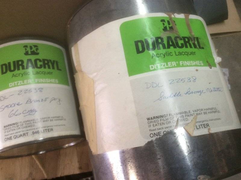

Unfortunately the formula for his vinyl mix wasn't on the can. I'll look a little more it could be on a print out near where can was. The paint code for my gold interior is PPG and the code is DDL 22538 Saddle Bronze Metallic. Asked why they couldn't use paint formula for vinyl told you can use paint code for vinyl.

ya pretty much the same thing. Theres a additive that goes into the mix so it can be used for dash board , seat coverings. We used to do that back in the 80s auto wrecker parts and clean a spray at adhesion promotor to the material then spray. On the seat backings it usually cleaning with comet really well to remove any oils spray color , then clear with a flattening agent mixed in so the metallics would not stand out so much. The lacquer days was a little different but a whole lot easier. Love that stuff.
View attachment 913660 View attachment 913662
So I assume this is the same paintcode code I need? Thanks a ton!
