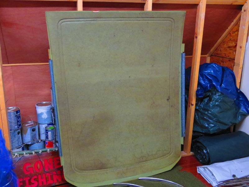

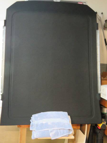

Here's a pic of the one piece headliner --- for those who might be missing the piece.

Yes, I have those 2 metal pieces on the sides if you need them.
Thanks for the replies---I dont know if I have the metal brackets that were discussed but a moot point as I dont have the card-board one piece "board" and I dont think it is reproduced---anybody got one of those??? I asked about the bow type headliner as I see them advertised as a replacement for these Chargers--I will look in the car and see if the metal pieces are still there but again I need the card-board piece
I actually had a ratty correct headliner to use as a base and had it covered in copper vinyl. I'm sure you could do the same if you had the dimensions for the original and used a piece of Masonite or similar and have an upholstery shop cover it for you. Just my two cents..:)
