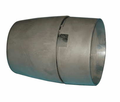

Mancini Racing sells a collar like that
1 for a 68-70 it's like $159.99
they may have them for an earlier model too
I can't remember who makes them
call Mancini Racing & ask maybe
