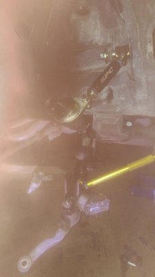

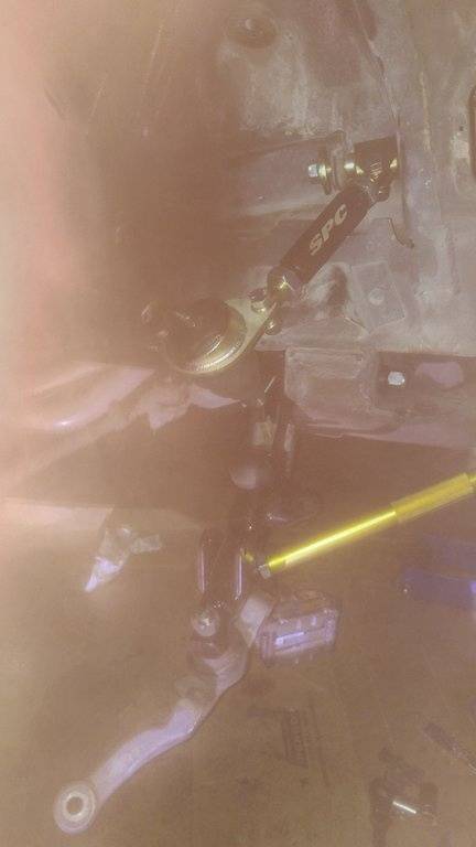

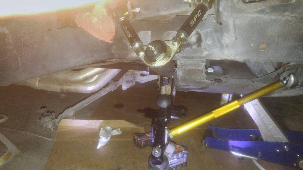

Finally getting going on my Coronet. After several house projects this summer and getting the paint done on the car, starting to get some of this pile of parts on. Got the passanger side dissasembled and mostly back together tonight. Gonna finah this side hopefully tomorrow with new disk brakes.
Yes its qa1 contol arm and strut rod. Pst 1.03 torsion bar and spc upper control arm. Building the wilwood 12.19 disk tonight and have to wait till sunday to finish since i didnt have tie rod ends on order yet. Adding aluminum adjuster sleeve as well.
View attachment 499049 View attachment 499050

No pics today but got the passenger side most the way done. Note for anyone using the SPC upper CA. Before installing let the adjusters out on both front and back where there is about 3/4 inch of thread showing otherwise you end up with the a boat load of Negative Camber. Still need to figure out the steering linkage. Thought I just needed tie rods but when I got into the driver side I found that the pitman arm is trash and wobbles around in the center link.

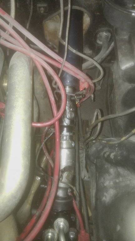

For anyone interested I installed an ididit 35" tilt steering column so did not use the Bergman adapter. I did require 2 u joints for this application one to go from the 36 spline borgeson to 3/4dd and another from 3/4 dd to 1"dd steering shaft. with the 35" column I needed about 6" of 3/4 dd rod to connect the 2 u-joints to the each other. No one makes a 1"dd to 36 spine borgeson u-joint so that's why i went this route. I go into so much detail because I refused to pay 900 dollars for Ididit or Flaming rivers Mopar specific column. Its a joke because its still a GM column that they slap a wiring adapter on and a couple of holes to connect your original column mount. I did a lot of research and measured my original column the best I could and found that their 35 inch column would be the best option the shortest that may work would be 33inch .You can pick either of those up on Amazon for 299 unpainted and use flaming rivers lower mount adapter 49.99 to hold the base. it mounts to the original floor mount holes to reduce the hole to the new 2:shaft diameter. 32 inch which is the most common will not work, it will be to short to reach trough the firewall.

There is a 36 spline to 3/4 DD u joint, I'm using one myself. Just gotta ask....why use 2 ujoints? Unless you had the DD shaft going through a bearing support, your asking for trouble. The DD shaft should go straight from the ujoint to the column.
Because the Ididit column is 1"DD. Could not find a 1"dd to 36 spline adapter so I had to go 36 to 3/4 and then 3/4 to 1"DD.

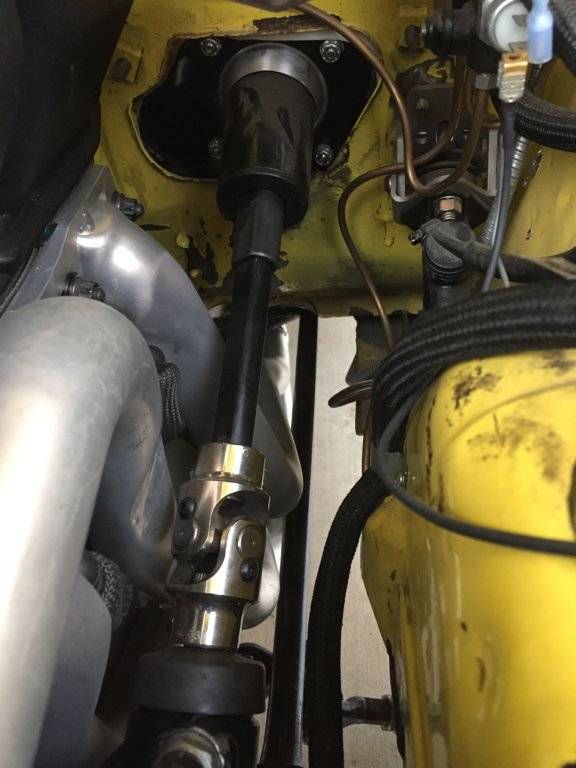

The inside of the 1 DD is 3/4, so the 3/4 DD shaft slides into it. I'll post a pic of my set up.
Did you push the 3/4 dd shaft into the 1"dd shaft? How are they fastened? I originally considered doing that but the manufacturer expressly states not to do this as it will round out the shaft over time or possibly even break the 1dd shaft. .
Just push it inside. It needs to be this way for safety, wouldn't want the column to punctuate your chest in a front end collision.
It's perfectly fine for the shaft to sit inside the 1 DD, you need the slip for the reason stated above.
Ok sounds good. Here is my current set up but that make complete sense.
86 that top ujoint and get a longer DD shaft and your golden!
