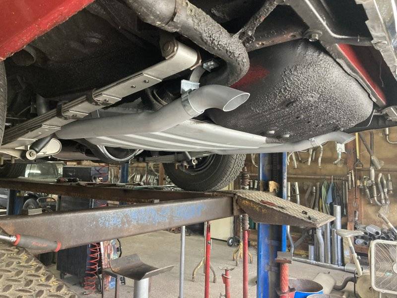

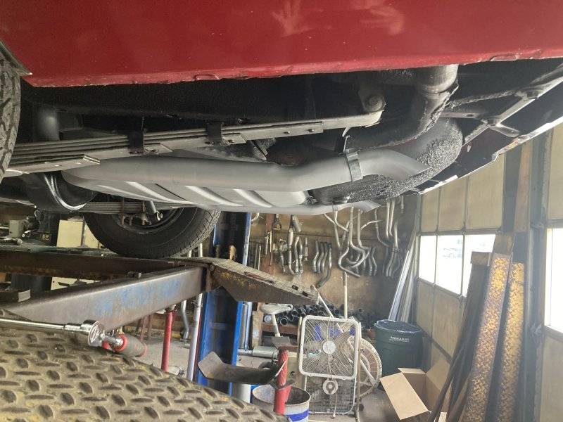

Finally I have a correct exhaust on my 67 Coronet R/T. Funny how you would think it wouldn't be that hard or That Expensive to get a correct looking exhaust system. Anyhow looks great now.

Not trying to be critical but those seem to dump out pretty far ahead of the bumper?

Thanks and what I can see since the 67 R/T had no chrome tip option this is the style that should be on the car, I think.
Jerry's post validates my memories of 54 years ago when the local Plymouth dealer took a beautiful red '67 R/T as a trade. I was struck by how far front of the rear bumper the turn down pipes were situated, in sharp contrast to the extended tips on the same year GTX.

Well I did quite a bit of studying of pictures of different cars and had my local guy do most everything. He is good at replicating the factory turns etc on the exhaust. He did my 65 Coronet 500 383 survivor a few years ago too. Thanks for everyone's input etc and the photos.

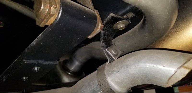

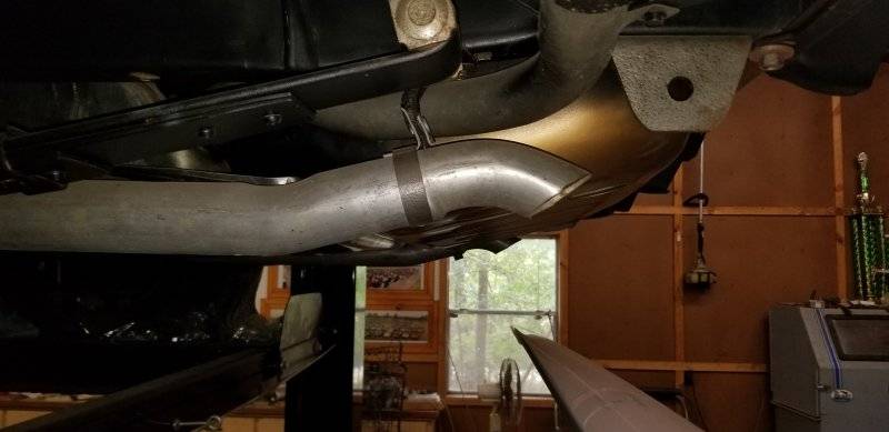

They were short like that from the factory. 1967 R/T never had optional bright tip; the ONLY Chrysler Musclecar to not have them either standard or optional. Every '67 GTX had chrome tips as standard equipment. The tail pipes are so tight around the gas tank. Mine has an occasional rattle that I have not tracked down. Here's mine.
