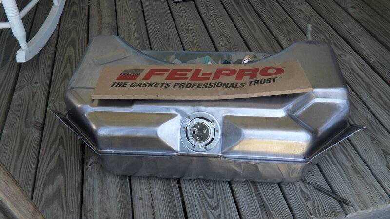

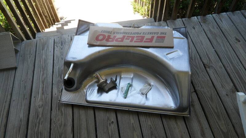

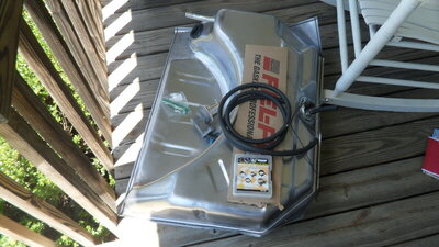

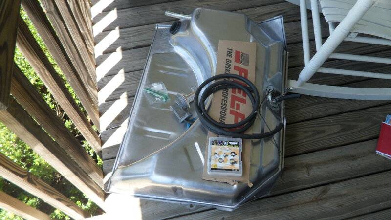

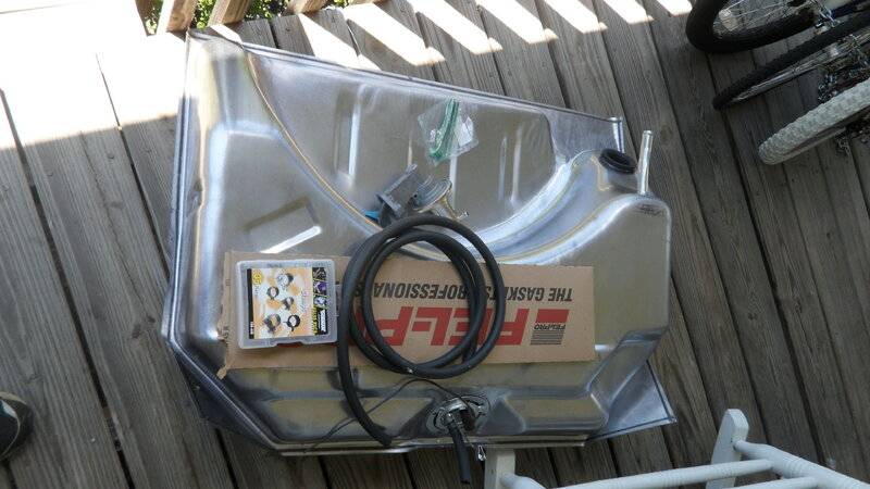

Hi does anyone know the proper replacement fuel tank for a 67 Coronet 2 dr hardtop 383 car? I am looking at the spectre premium CR 14, can anyone confirm the fit?
Thanks!
Its the same one I purchased for my 67 Belvedere. So it looks correct.
CR14 correct, I've probably used 15 of them.
Thanks all I figured it was right but I went and measured it just to be sure. Hopefully they do have it in stock like I was told and it's on the way soon, seems a lot of places are sold out but they did say they have it and a new strap.
Thanks again!
Before you seat that tank, test the ring seal and the sending unit. So much pain on here from leaking tanks ect.....
That tank and car are long gone.. lol I installed the sender right there in the shade on the porch. The sender came with a lock ring and gasket but so did the tank. I used the one from the tank.
Be careful w that upper vent tube. I've seen them crack the solder joint where it goes into the tank while trying to wiggle on the hose. Lots of WD-40!!!
