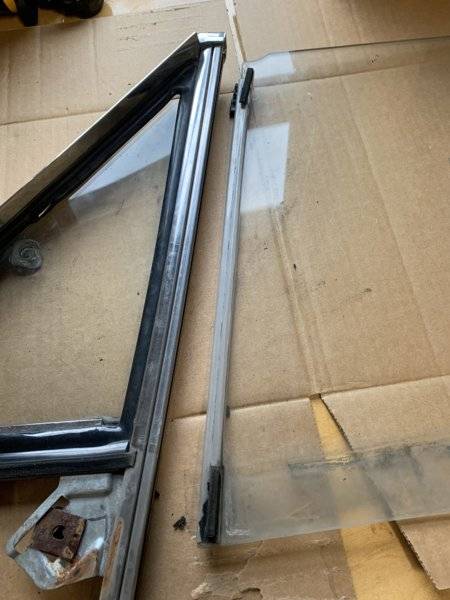

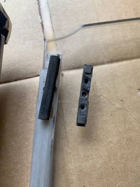

So i lubed all my windows and they work 100x times better except the passenger window, looks like the clips that hold the front window in were broken. So I pulled the window out and cant seem to find the clips or the weatherstripping (plastic looking film) does anyone know if this is a updated replacement for this?
https://dantesparts.com/i-30497701-...dy-1967-1972-a-body.html?ref=category:1389385
see photo for what I'm looking for.
