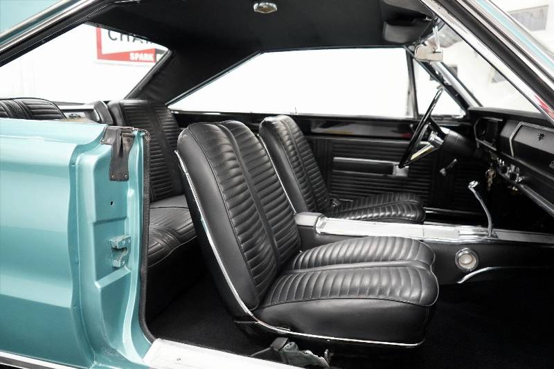

Looking at this one - I see a restoration by someone unfamiliar with Mopars. At first glance it looks like a nice car. BUT,,,,,, The air cleaner is later year 340 style Hammer marks at the rear footwell area. Ford-style starter relay. Rad support blackout, trunk finish, ft seat covers, heel pad/gas pedal placement all look "quick flip". Contour of rear lower quarters - especially right side - don't look quite right to me, though I may be wrong there. But looks like a patch panel on the right (trunk photo). I think the rear decor panel should be a darker argent. Painted latches/strikers - screams quickie deal. Overspray the radiator & headlight harness? Not sure what's up with the hole in the B-pillar. Some smaller details like the extra dash warning light, lots of wrong underhood details, dash knob inserts...some easy to correct, though. Needs battery cable, painted wiper motor, wrong master cyl. etc etc And whats with the plug in the intake in front of the carb ? In my opinion this car is worth mid 30s range. At the most. Not that a damn nice 67 GTX wouldnt pull upper 40s. But it aint this one

Why do you say the master cylinder is incorrect? I'm pretty sure that is a power drum master?
Aftermarket lid.
But the backwards $1000 340 aircleaner is a score.
For $50k I would think the underside would be a little better and underhood area. Correct air cleaner is ~$500 now.
Looks like $10k of dealer markup on a $35-40k car.
I would think you could find a private sale at that money and a much better car.

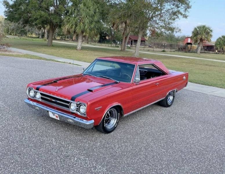

Came across this today on fb. Not sure if it's legit or not. The same user also has a blue 67 Coronet R/T listed.
Thanks for that.
Looks like a real decent car . I wonder if its real though
Ive forwarded it on to the man. Just in case
I wonder too. I think it said it was in the Boise, ID area but those trees don't look very "Boise" like to me.
