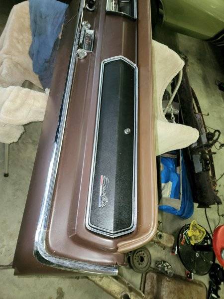

1967 GTX dash finish?
1:50 AM
Nov 1, 2010
18
7
Denver, CO
I am still researching how the dash is finished. 881 paint code, I believe the interior color is PB6. The question, is the dash the same color as the interior door panels or is it the same as the exterior color.
I believe it is the same as the interior color with a suede finish. Next question, is the front of the dash gloss and the top suede or all suede?
Thanks for your replies.

All suede finish.

dash is all suede finish, steering column and tops of the doors are gloss

Dash & package tray darker were than the other interior colors.
There's been some argument on '67 columns, but I don't recall what my '67 GTX from 40+ years ago had, sorry.

I’ve had two 67 R/Ts and both columns are suede. Both were original, one car was refinished by me but suede for sure before I repainted. Other car is still original.

Yeah, the '67 column finish was brought up on Moparts, and it seems that '66s were gloss and '67s were suede.
I'm not an expert on the '66-'67 cars, though.

67. As I remember, the dash was a darker color than the door panels. Even after about 40 years, and the door cards faded, I can just imagine how bright they were.
