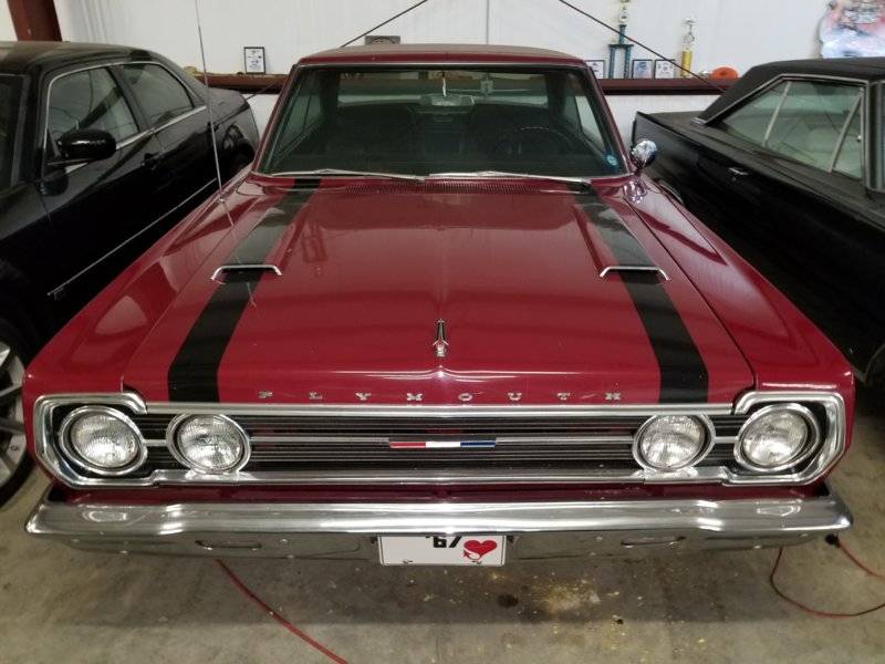

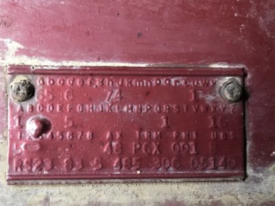

Need some info. Can anyone tell me if the fender tag on my car shows anything about stripes?
No, under UBS there would be a color code under the S if it was a car with stripes.

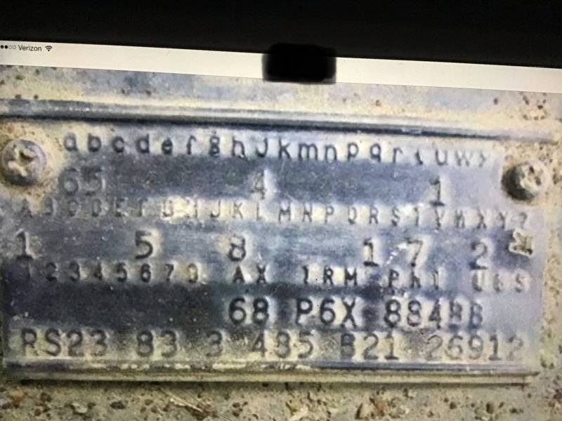

You can have a screwed up fender tag like one of mine.
So what would the “B” under the “U” on my tag signify?
The B under the U is Black upper door panels. Nothing under the S for stripes.
Jerry, there is nothing screwed up about your fender tag. That is how they code the stripes on a 67 GTX. There is never anything under S on these 67 RS cars.
It is said that only about 25% of them has stripes so you don’t see it very much. I don’t even see it that much when looking at tags.
The WS cars had the stripe under the S. Thinking this over, stripes under the S were a thin pinstripe. Those were put on by the stripe machine.
The 67 GTX stripes were painted on. Probably at the paint shop and masked off. They were done after the body color. So the code goes next to the paint code and has the number 4. Guess what, they are Exactly 4” wide.

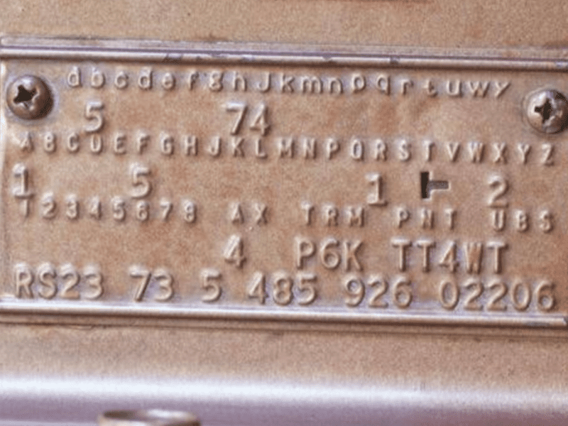

check this one
I think the "4" under the "T" is 294 which is the sales code for sport stripes. A paint code under the small "s" is for horizontal roof pin stripes. I am curious what the "W" & "T" indicate .... 2 different paint codes?
Going with what R413 said, the stripes are W= white and the upper door panels are T.
Good call on the 294 for the stripes.
Roof stripes were on 66-67 chargers. Most cars have the stripes code under S.
Jerry has it right on the W and T.
