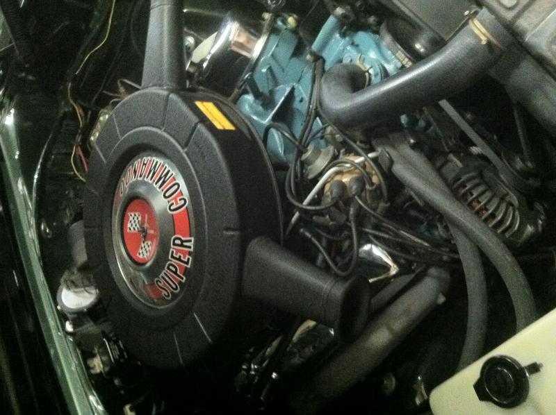

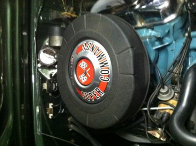

Mine is dual snorkel with wrinkle finish.

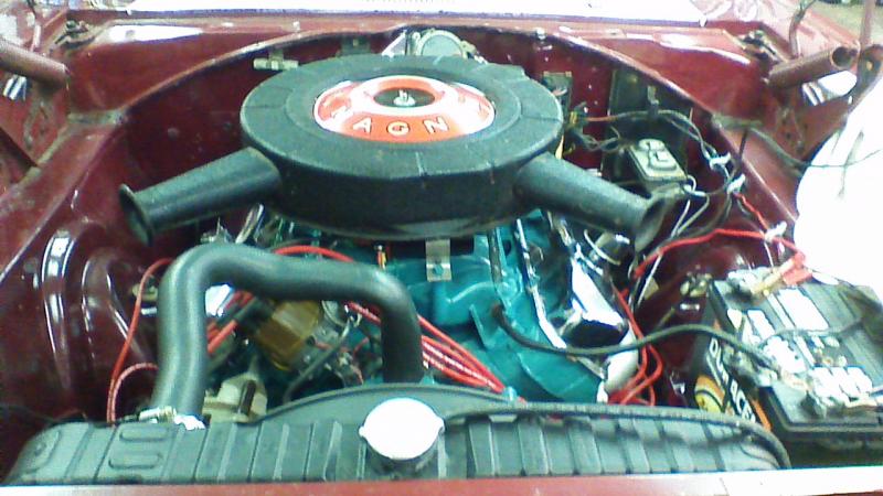

This is my 67 r/t, the air cleaner is the original that has never been painted.
