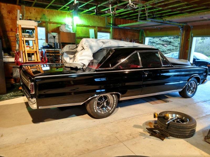

I just put 255/60/15 tires on Wheel Vintiques 15x7 steel wheels on my 67 Belvedere. No problems at all.

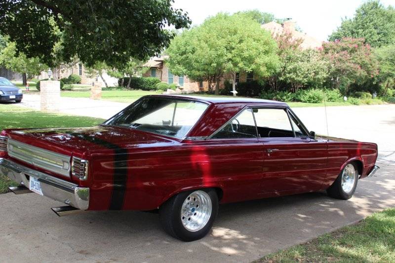

I can put 275/60/15 on 7" cop wheels on my 67 and they center between spring and fender with disc brake conversion. Will have to go 255/60/15 with my 8.5 Centerlines.

275/60 is biggest with 15x7 and 4 1/4-4 3/8 BS. Or 15x8 with 4.75-5 BS. Tight, but fit. Is a bitch to change tires, but the price to pay to put nice size meats in the back of a 66 or 67.

I think a 275 is a bit wide for a 7" rim. It will likely wear out the center of the tread.
