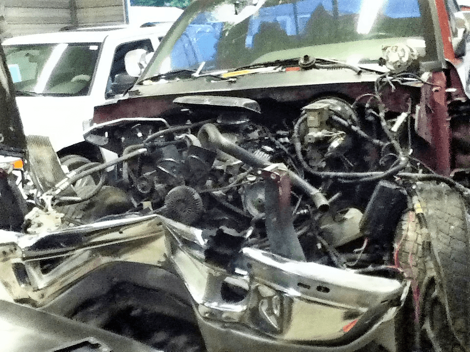

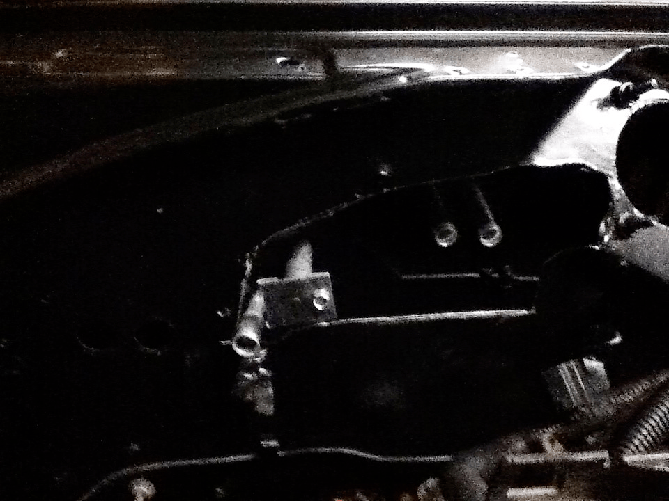

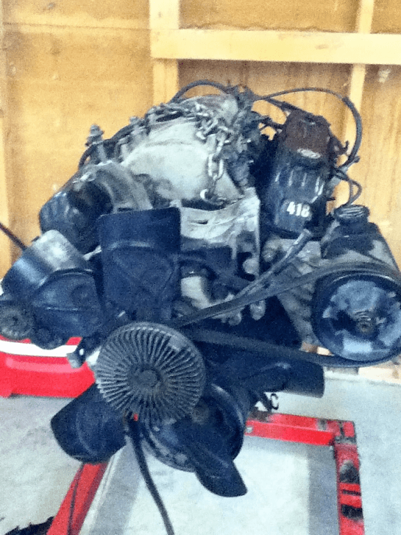

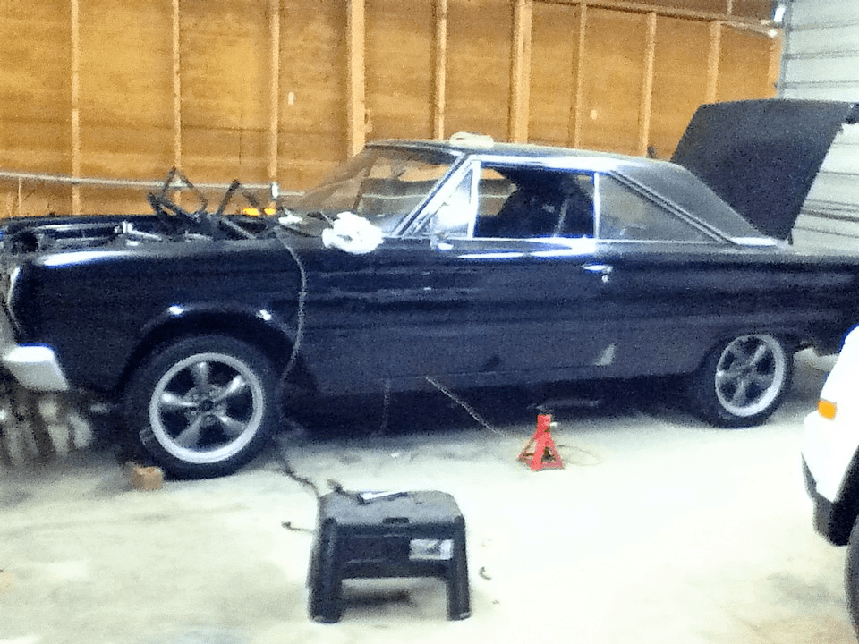

Hi. I'm new to the forum, and want to document my Project. It is a1967 Satellite, building the car for all around performance, and cruising. I've had this since I was 18 years old(36 now), I drove this car in high school. Then retired it to weekend duty when I dropped in a nasty Big Block. When the gas prices sky rocketed, and only getting 7-9 mpg I decided to drop in a small block. I shopped for a 340/360 for a few months with very little luck, Then my friend was in a car wreck in his Ram pickup. Thank god he and everyone involved were o.k. The truck was totaled, so he offered to sell me the engine for my car, then I asked about some other parts from it. We quickly came to an agreement for the engine, transmission, wire harness, fuel pump, A/C system, and misc. for $500.00. With the whole truck at my disposal, I used every piece I could.

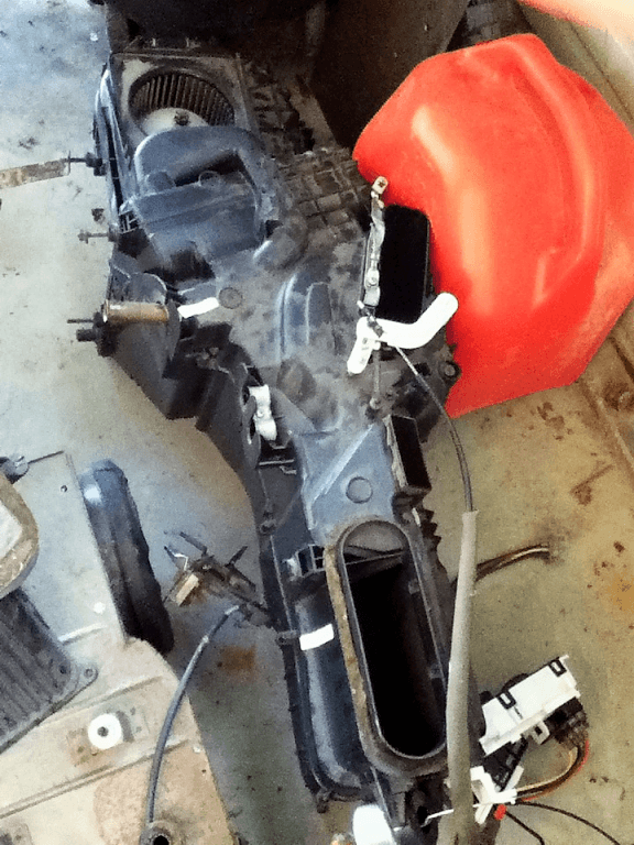

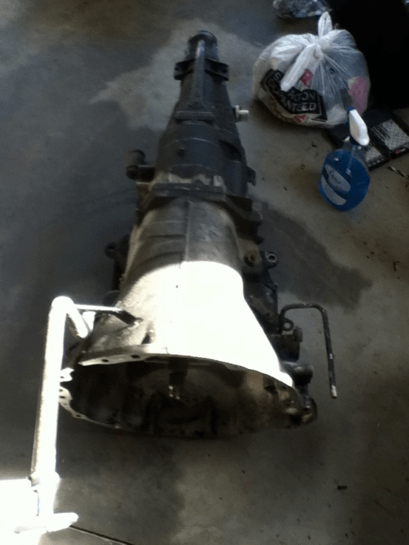

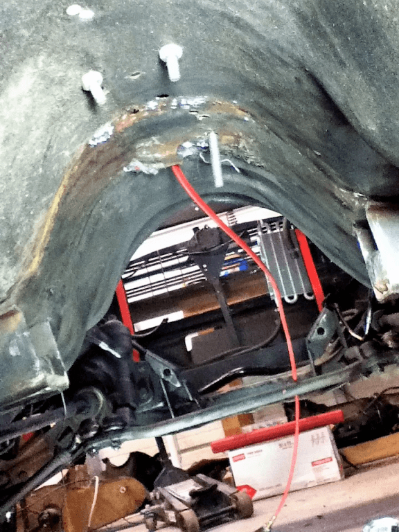

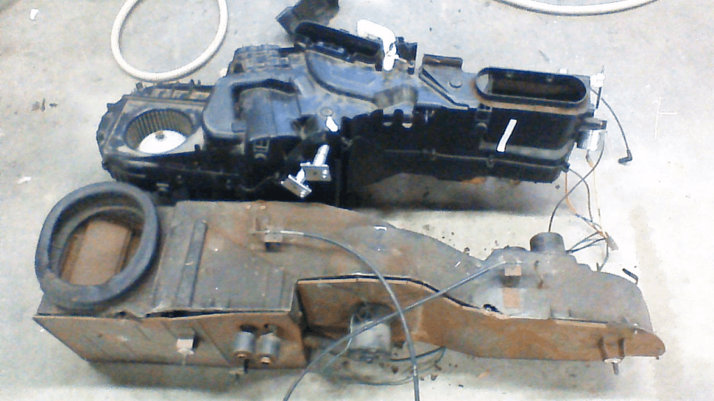

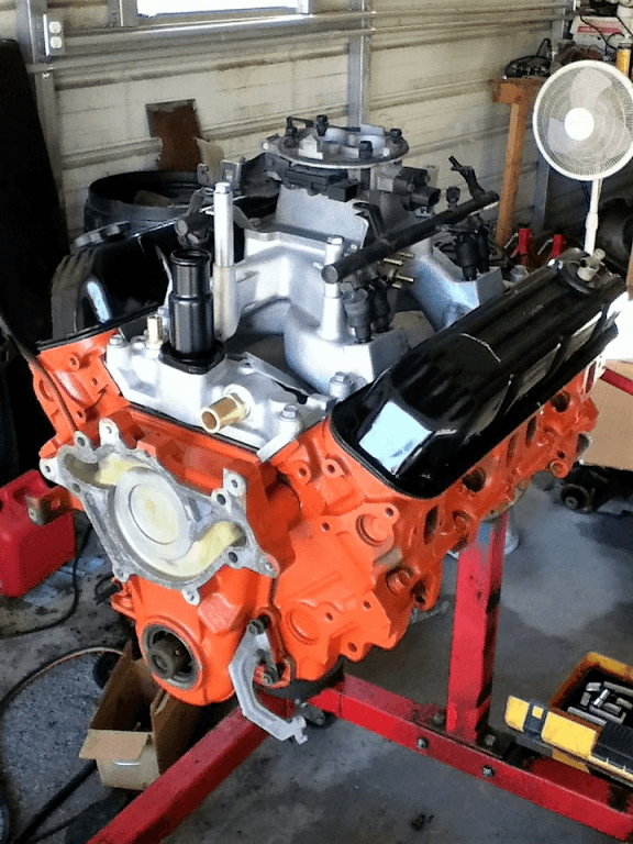

The 5.9 Magnum was in great shape internally, it didn't need to be rebuilt, But when I went on rockauto.com Parts to rebuild it was so cheap, I could not afford not to. I have driven the Ram a few times, and thought it could use more power, found a website called hughesengines.com where I picked up some performance parts, suck as a small cam, valve springs, other odds n ends. The transmission was services 40,000 before the wreck so it was a good unit, only thing I added was a shift kit. the trans tunnel on the Satellite needed some work for the A518 to fit, But wasn't too bad. The HVAC unit did fit under the dash with very little mods.

Can't win them all. the next summer the car did great... until late August I could not drive RamRunner with the A/C on, the temps would climb to about 230*. Had to be a leak somewhere, but where. Saw nothing at the water pump, hoses, or intake. Then one day I was working on something under the car when I got dripped on. found my leak. I took the car to the radiator shop, they confirmed, a leaky freeze plug on the back of the block. This will not be an easy fix, as it will require an engine pull. So while it's out might as well upgrade.
Here we are now. In the process upgrading some parts. This video will catch you up.

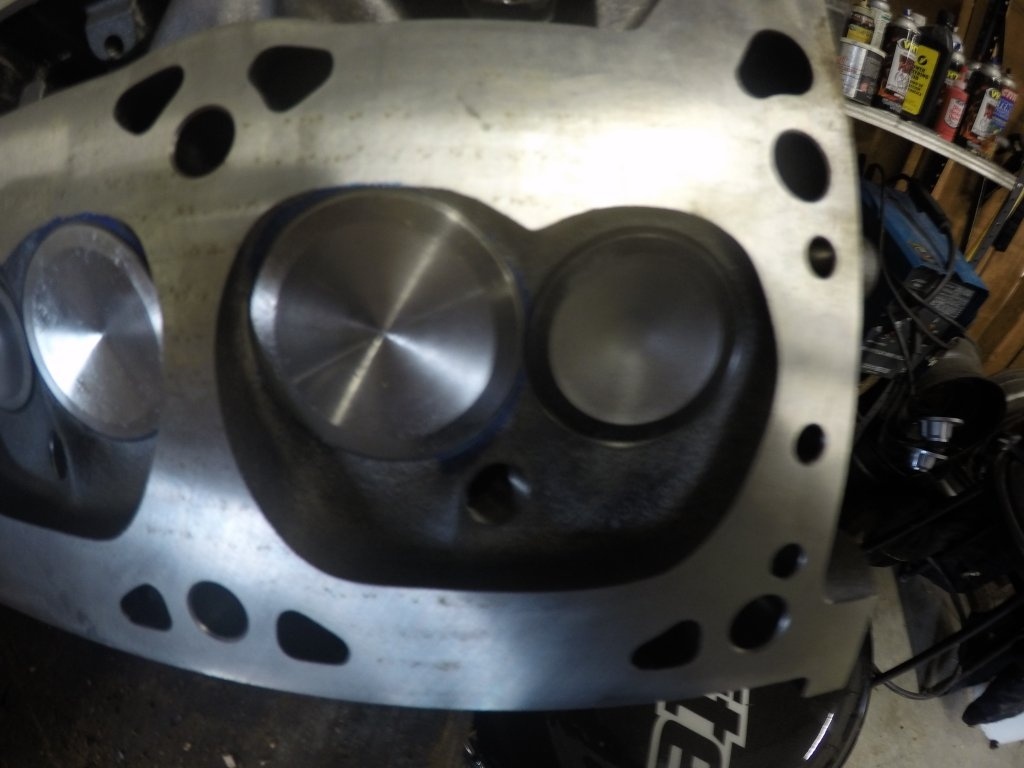

In the last video I mentioned maybe using LS 2.00" valves, after meeting with my machinist we figured out the LS valve would not work, so I went with Mopar Magnum 2.02" valves.

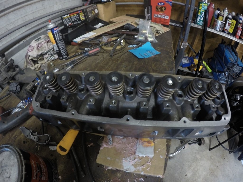

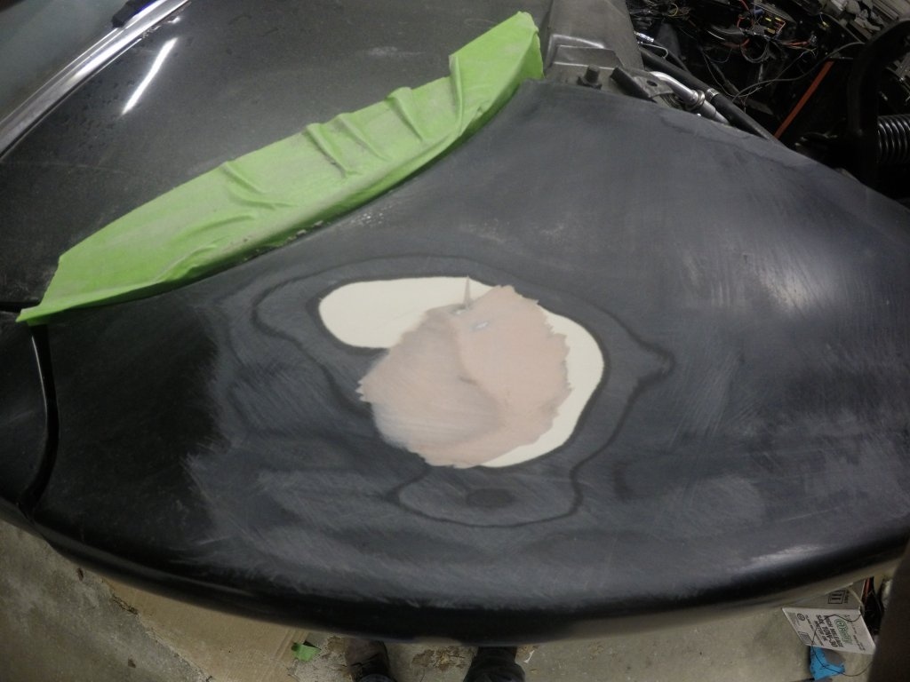

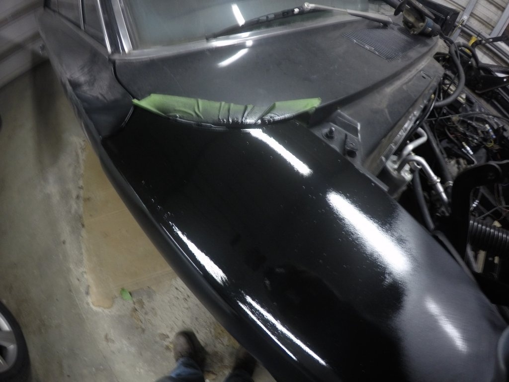

My Magnum Engine Quest heads came back from the machine shop with the 2.02 intake valves. While I had to wait on them, I decided to shave my mast antenna (aways hated the way it looked.
