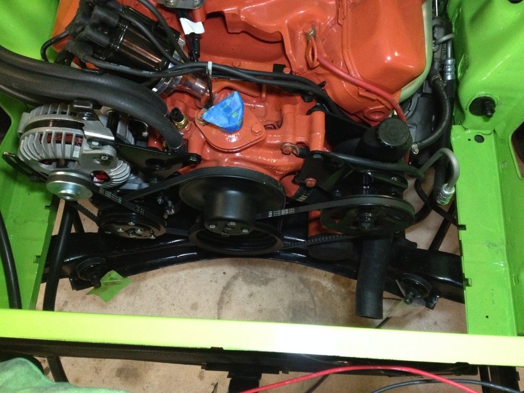

Repurpose the old system with a modern compressor. I install aftermarket air in b bodies for guys using classic auto air and in my opinion if you have a car with stock ac, then the stock system is the way to go. I attached a pic of the aftermarket system which I don't prefer over stock.

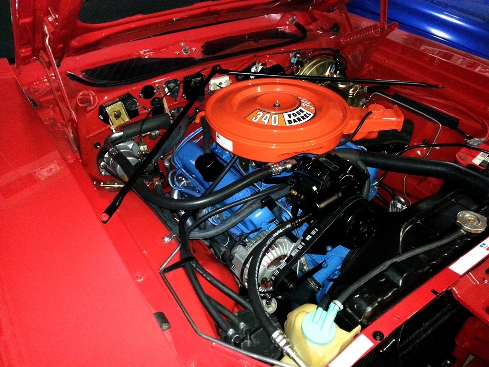

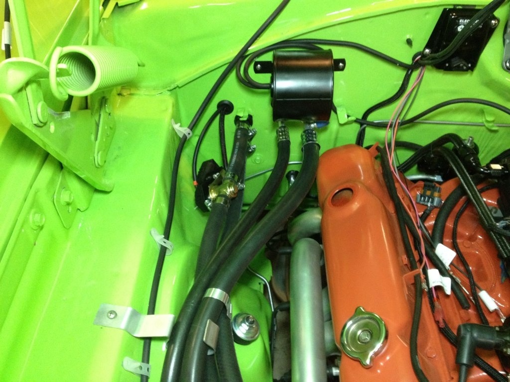

Here are some pictures of my 70 Road Runner with the (mostly) hidden Classic Air system during construction. Hope these help.

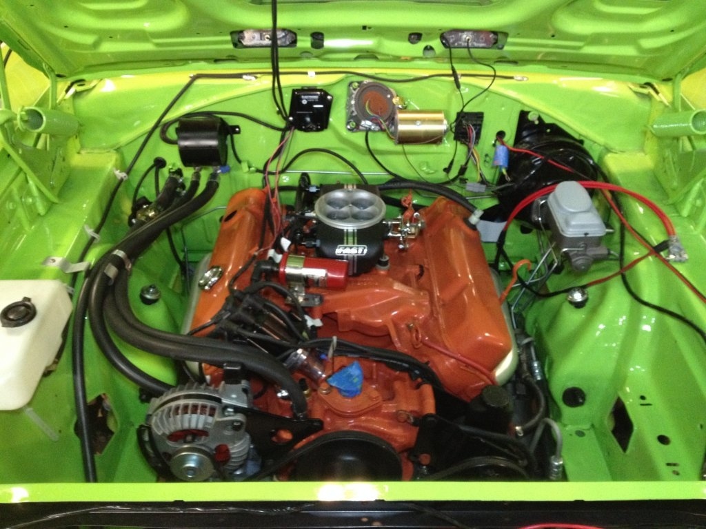

Very nice engine compartment! Well done!
