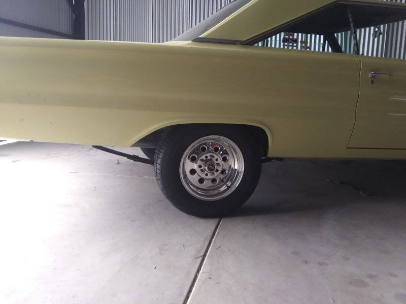

I have seen a lot of people running 15x8 draglites and i know their running 4.5 bs. Dont know if they trimmed wheel lip

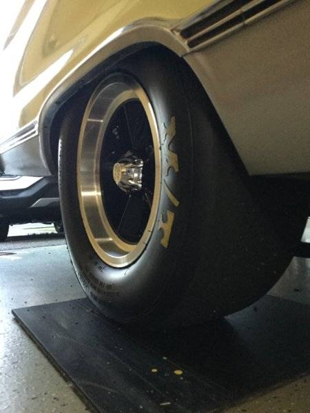

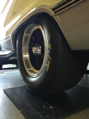

Ive been running 15x8 with 4-1/2” bs rims with MT 28x9 ProBracket Radials. They’re substantially bigger than a 255, a little narrower than a 275. Wheel wells are 100% stock with the stock trim. They fit without rubbing, but are literally stuffed in there. Getting them in & out is a major p-i-a.
Thats bitchin LemonWedge!!!!im ordering draglites with 4.5 backspacing and 255s.will post pic when mounted
