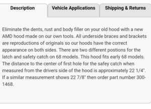

There is a difference between early 68 and later 68-69 hoods. The difference I know about is the location of the safety catch mounting holes . From the edge of the driver side hood to the first hole for the catch is: early 68 =22-1/4"...late 68 & 69 = 22-7/8 " I don't know if there is any other difference. I got this info from AMD online catalog. They make both hoods, but the early is out of stock and no in stock date . I can get the late 68-69 hood, but my Plymouth appears to be an early 68.
Anyone know what, or if, I can do to put the later hood on my earlier car? Thanks for any input........................MO

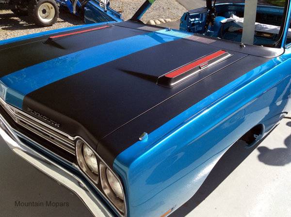

Also the air grabber slots are different... On 69s they face more upwards, on 68s they face to the sides.. I don't believe that affects fitment though if you are not worried about year-correctness
68:
69:
68:
69:
That doesn't matter. They interchange. It is the early 68s had a different style latch that is tough to find and costs quite a few pesos. If we can switch the latch tray and hardware over from the later style it would be simple(and cheaper as i have the stuff to do that if it works).

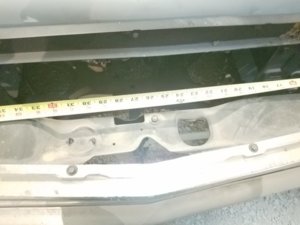

OK, I do not have a factory parts book, having to relie on AMD information for 68 69 Roadrunner - GTX hoods. THEY say early 68 safety latch location is 5/8" different than late 68 and 69. That means the horizontal header panel (or cross bar) has to have the rectangular hole where the safety latch "hook" goes through changed to line up with the different safety latch location.
I have found that my 68 Sport Satty is an early one according to the safety latch location. ....After-thought could there have been a change in the safety latch itself, to make the later latch line up with the same header panel( crossbar) hole, therefor not needing a different one? ..................................MO

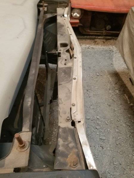

My early 68 belvedere. Does anyone have a pic of the later 68 with measurements?
20180201_165057.jpg 20180201_165048.jpg 20180201_165107.jpg Screenshot_20180201-170054.png

This is the AMD description MO is talking about for their hoods.

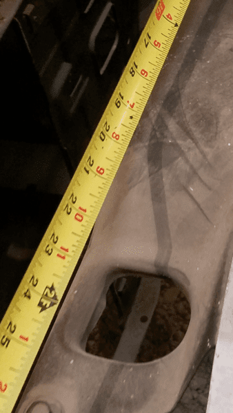

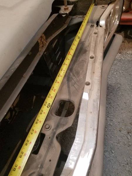

Dale your last pic on entry #15, I assume is measured from the end of that panel right side, ? . or to the edge of the hood - inside of fender lip. right side?....Mine is measured right side of hole to end of panel. Near side of rectangular hole is 22" and far side is 24" I can't understand why yours is different. Could one of ours have been wrecked and put together with wrong pats???.........................MO
