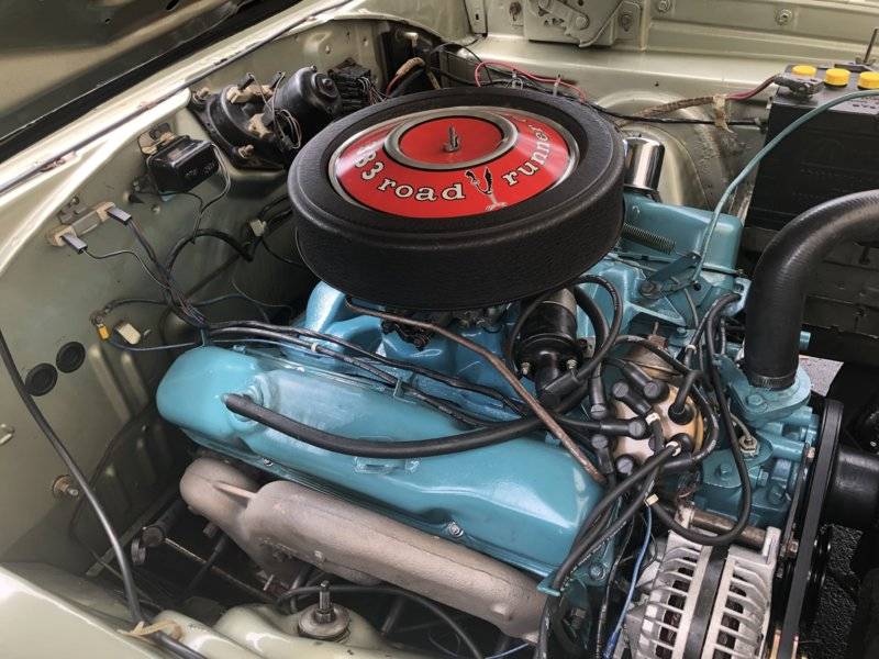

My stock appearing 383 build. Currently run a best of 12.10 @ 113+. 10:1 compression.

451, 10:1, 800 Eddy, ported intake (I did) ported heads (professional, but not Dwayne Porter good) custom solid lifter cam, 1.6 Harlan Sharps, 2.14-1.81 valves, 3000 PTC converter, 3.91 sure grip. 3520 race weight with me in.

What size exhaust? I have about the same combo but with a jetted quick fuel 735 cfm running Tri y headers and 2.5” exhaust and went 12.80 on a hot 90 degree night. My car weight is 3750.
