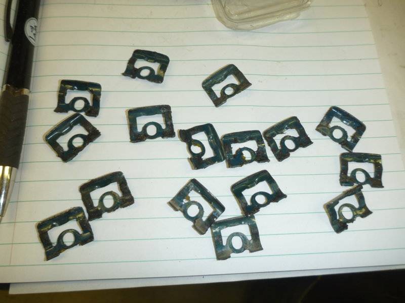

These are what I removed from my car and put most back. I don't remember them ever being replaced.. but they may have been at some point. They held the trim tight!

Cornpatch MO, can you post a picture of one of your original clips? There were variations in the clips used though the years and I am beginning to think that the assembly plant can impact the clip style as used. Typically the rear window clips are pretty much original to most unrestored cars, so it is easier to know what or how it was equipped. Front windshields have a more likely chance of being changed out through the years and more of a chance for the clips to be swapped out through the years. The A-Body applications have a even greater discrepancy than the B-Bodies. We have samples of most all of the original style clips that can be matched up to originals.
My original clips were not like those.....I just can't find the dang pic.....Mine were like the ones in the reproduction clips....
Never know about the variations, yours could have been original to your car...Those resemble the front large clips....

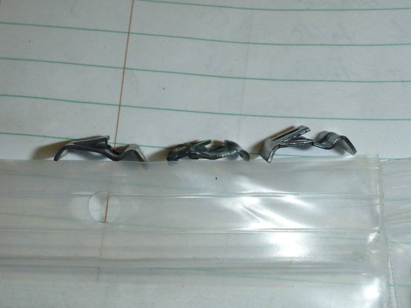

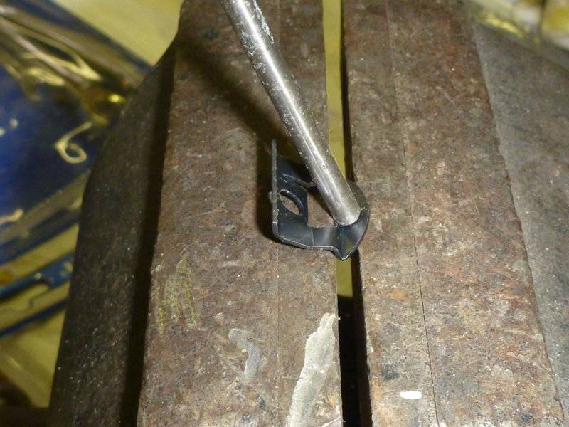

This was the shape of the repro's I used a few of after wacking a "tab" into them. Repro's on both sides, my original in the middle.

No, these weren't soft and took a lot of hammering to make a dent in them without a proper die. Glad I only had to do 3 or 4.

Are the 1st and 3rd and the one in the vise all the same? they look like the new ones I have. Do you have a side profile of the one in the vise to see what the dimple you punched in looks like? ..........................MO
That is one problem with the reproduction clips. The tempering in them sometimes is poor. I am thinking that the ones that your placing the divot in is relatively soft for you to be able to make the relief in it.
That is what my window man said. The metal did not have as much spring to them as the originals did..............MO
Yes the one in the middle is the OE and all the others are the same repros. I just used the punch to add a lip/tit as best I could, similar to the OE.
