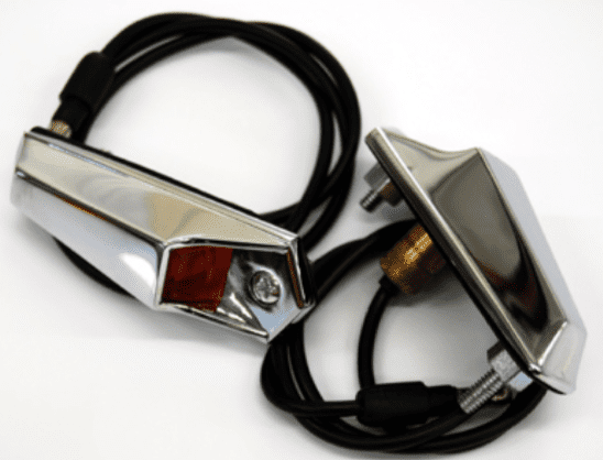

Also noticed on the same R/T mentioned earlier that the two holes in the pc board for the left and right signal bulbs just have black tape over them. It originally came with fender mounted indicators with the non-rallye 150 cluster. Was this normal in the early cars?
I wouldn’t have thought so, but maybe. Did it have the bullet shaped signals I assume?

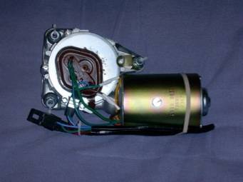

This is my original wiper motor when I got it back from Jules.. 9/11/67 SPD...

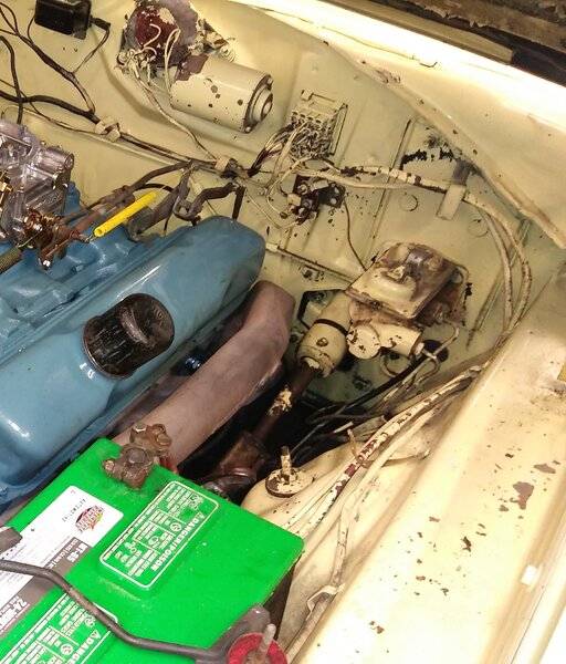

And here it is still mounted to the car...
