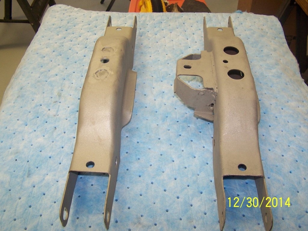

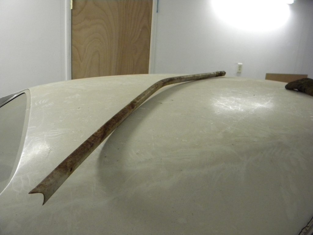

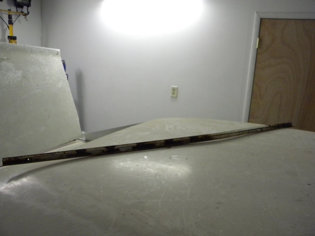

Can anyone identify this part? It was in the car and is painted the same color as the car. I cant figure out what it is.

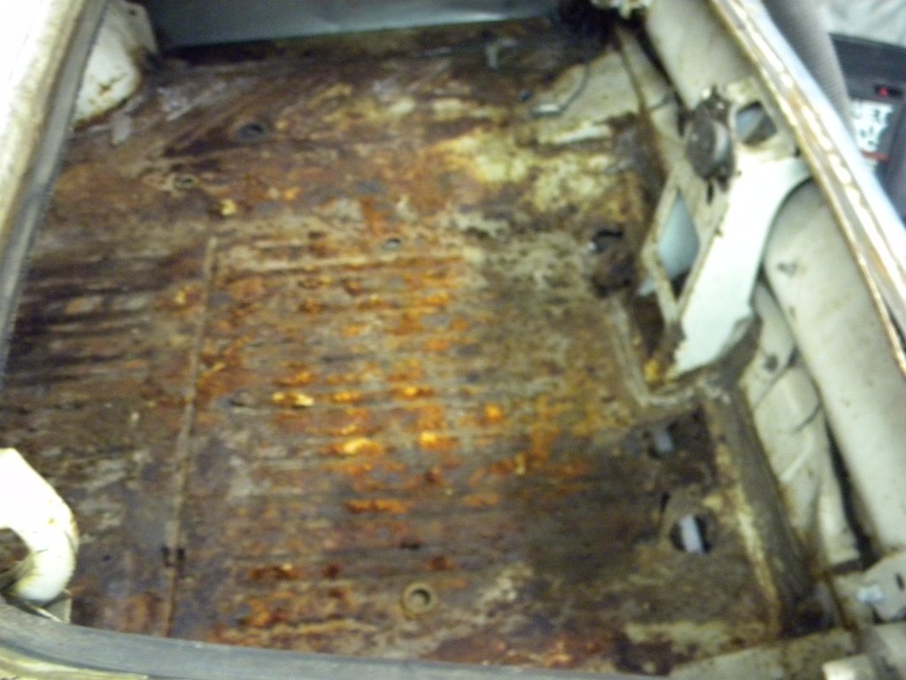

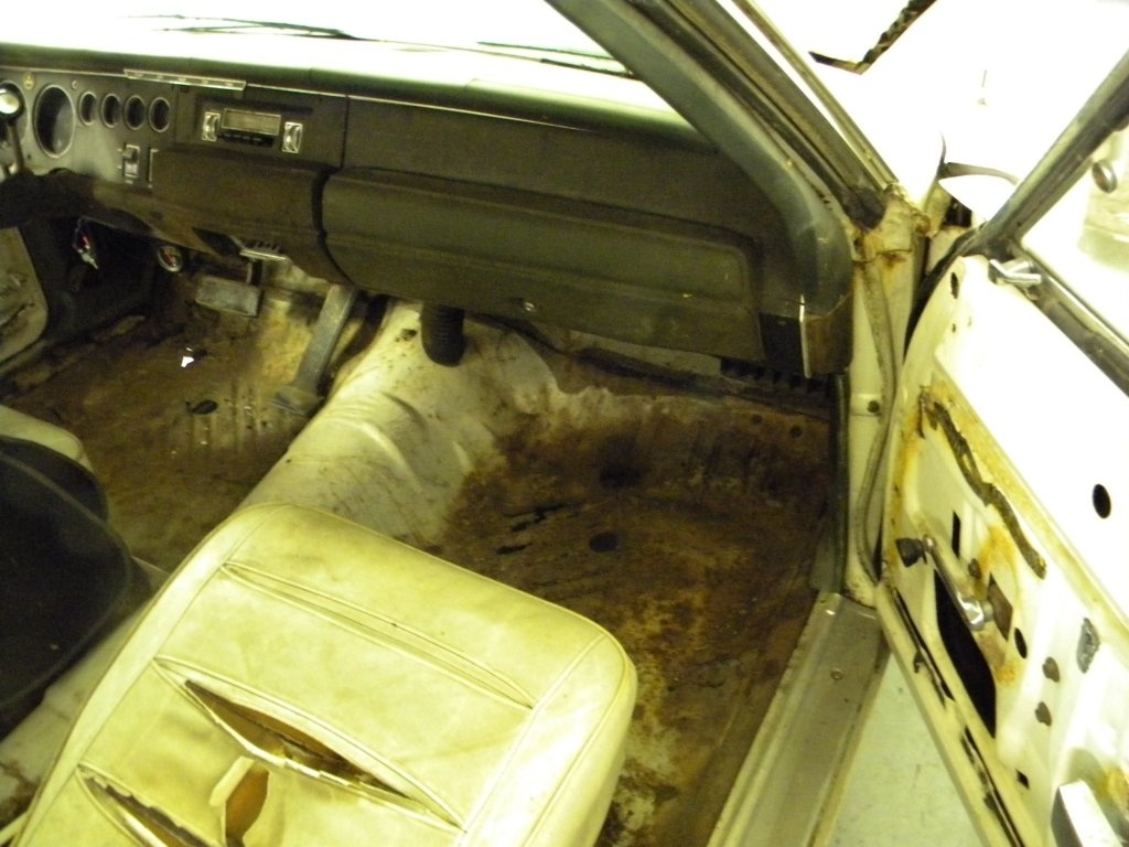

I have done body work on old cars for years replacing floor pans and full quarters as well as quarter skins. But this car will need a tail light panel trunk floor full interior floor and both quarters. Also the back 2 feet of the drivers side frame rail. Question 1 If I remove the tail light panel , trunk floor and both rear quarters do I need to brace anything and if so what and where? I would like to do this as I have a one piece trunk floor.

View attachment 349448 Can anyone identify this part? It was in the car and is painted the same color as the car. I cant figure out what it is.View attachment 349447
The part you are wondering about appears to be the left side upper roof rail that holds the headliner in place. You should have one for each side. There are 4-5 clips that fit inside the molding that clips onto the lip in the roof. Good luck with your build. You will love it when it's done.
And the winner is....Sixpactogo. Thanks man and I found the other side still in place.

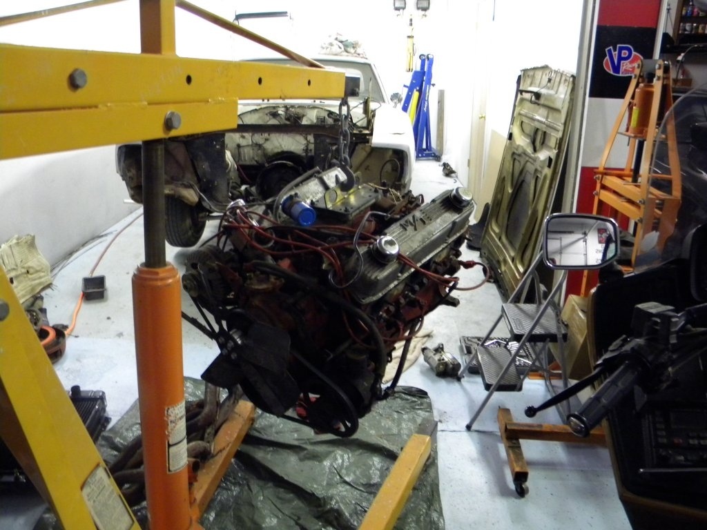

I got the 440 out trans is next. Man I had issues pulling that thing. They had a set of headers on it that were so tight you couldn't take them off with the engine in the car. I couldn't get the starter out with the headers on and the engine wouldn't come out with the headers on. They hit the torsion bars. I think it was all put together and then put in from the bottom. I was about to reach for my plasma cutter but got it out.
I finally got a better look at the engine bay and fire wall and it is in pretty good shape. I have a little work to do on a couple spots by the hinges but over all good. I feel like the journey is now under way.

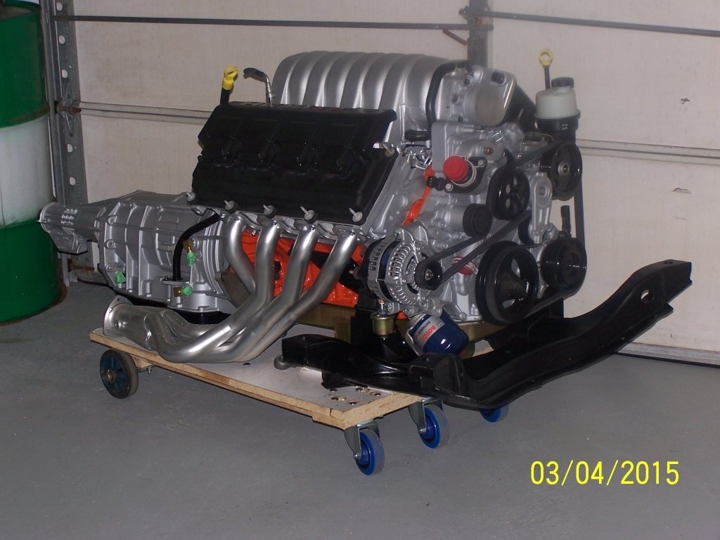

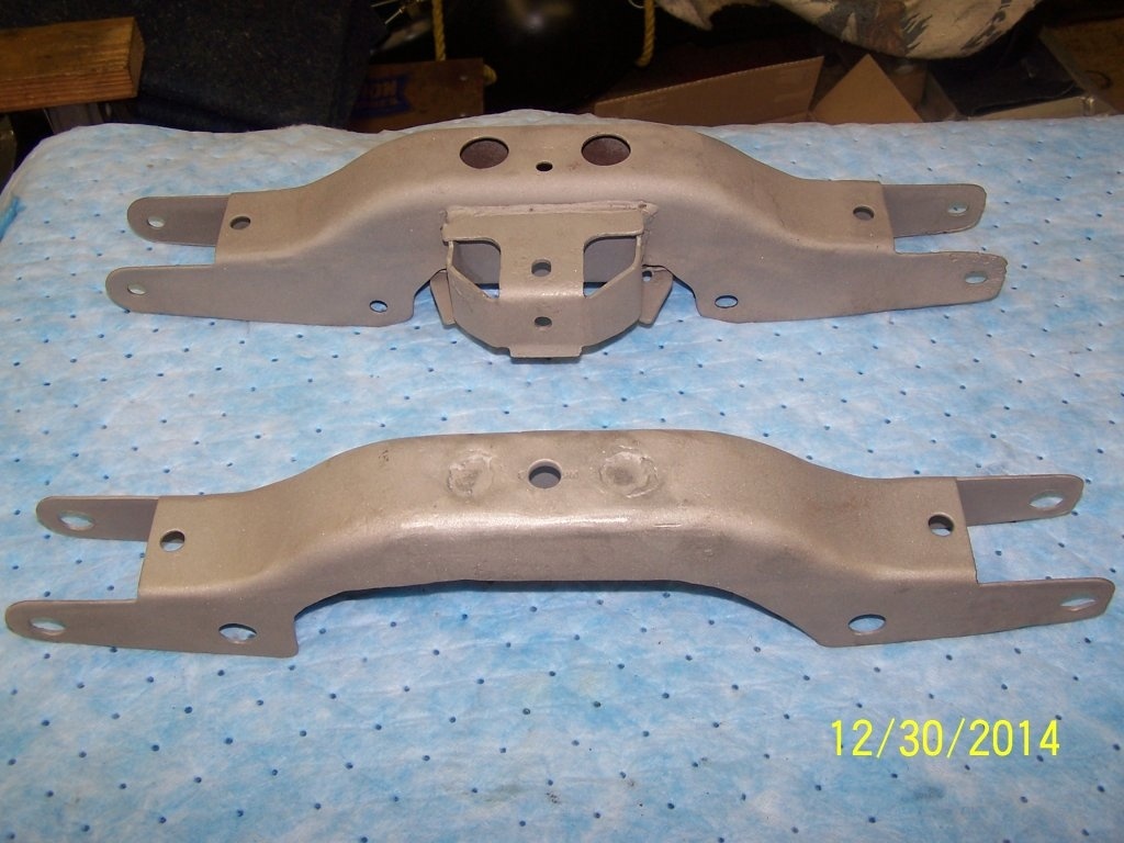

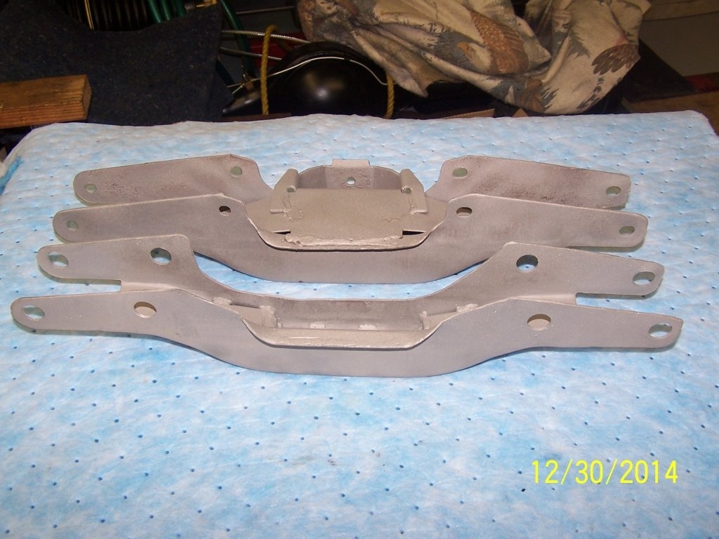

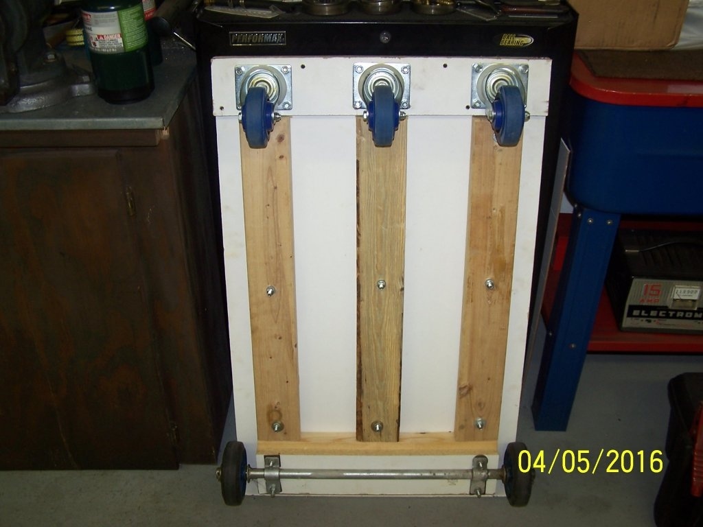

You are definitely going to want to put it back together from the underside. It works so much better with the engine, trans, headers, K frame and steering box all put together. It makes it so easy to drop the body down over the drive train when you are fabbing the tunnel. I had mine in and out probably 6 or 8 times before I was happy with the clearances. Here are a few pics of the cart I built and the cross member cuts. Your tunnel will have to be widened out and raised a couple inches to make room for the 5R45RFE. Have fun. I hope this helps some
