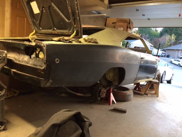

Original parts are always better than a reproduction, if you can find what you need. I used AMD fenders on a 69 Charger several years ago. They weren't terrible by any means, but did require a little work at the bottom rear where it attaches to the rocker. If I remember correctly, we had to cut off and reweld the mounting bracket to get things to line up.
Our fenders need some welding and fitting on the edges to meet up with the doors too. They are much better than the garbage AMD doors though.
