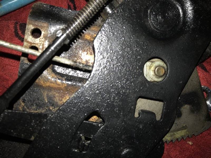

I did the search, I couldn’t find information on how to remove the cable from the arm mechanism. The bolts don’t look removable to unhook the cable?
C1511F42-D5E4-4622-9705-199047A7F735.jpeg 36A6FFE7-8996-4574-95D8-52EE722B11E4.jpeg FAE2782D-5833-40FD-AFD6-E07E1CA0DB5A.jpeg
In your second pic, top right....Focus on the circle opening.....There is a pin with a lock washer....Take a punch and punch the pin out...Just be sure not to lose the two pieces...They are reusable...
