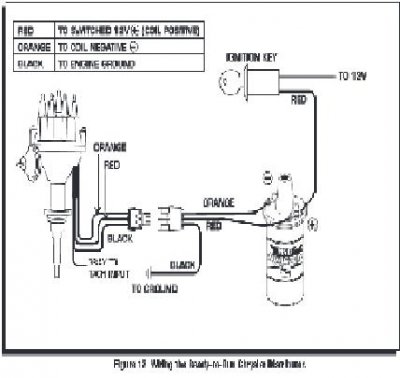

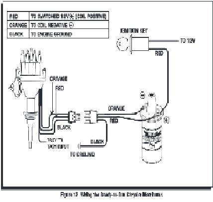

I forgot, with the MSD ready to run, you will not use the ECU.
Run 12 volts to the MSD distributor and coil no voltage regulator if you run a new alternator with an internal voltage regulator. Since your not worrying about originality it is best to reduce the total number of parts and one wire alternators are fairly inexpensive.. Your engine harness is going to only have oil pressure, temp sensor, horn relay wire, this is factory wire harness..

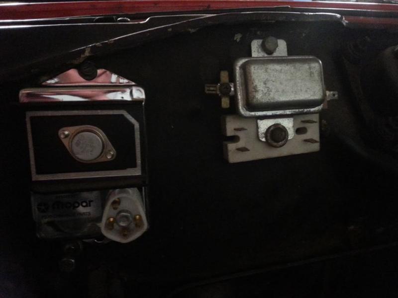

ok so if i understand you correctly if i have the one wire alternator and the msd ready to run ignition i don't need to ballast resistor or the ecu or the voltage regulator will try to post the pictures of the alternator and the 3 count em three items on the fire wall. The silver box above the ballast resistor I assume is an unnecessary component some kind of voltage regulator??? I think i have the right alternator and will post pictures.
i added some photos to make sure we are on the same page let me know what you think of this. I inherited this from the previous owner.
That is correct. With a "ready to run" distributor you not need the ECU and ballast resistor.
With a one wire (internally regulated) alternator, you will not need the external voltage regulator.
The tuff stuff alt I have has the reg built in the back, just make sure the wire from the battery to alt is a larger gauge.
