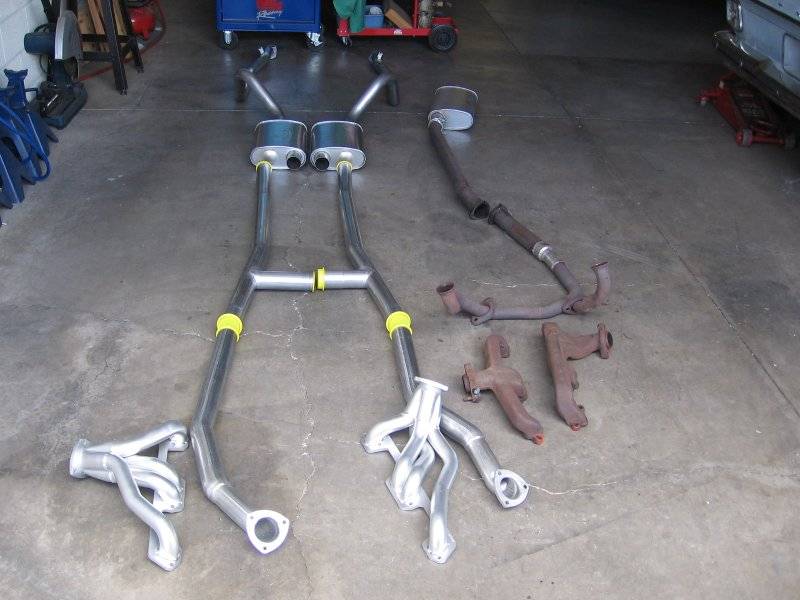

Photo is of the TTI system I bought for a 68 Valiant for reference.

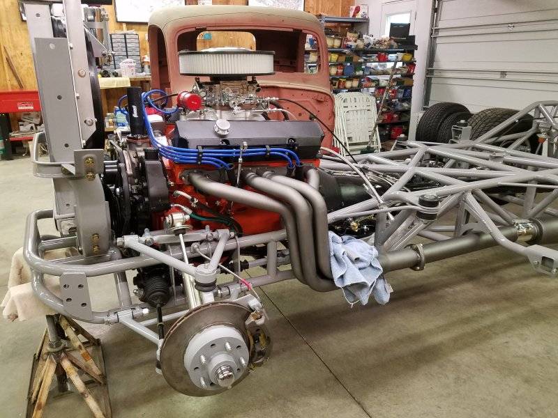

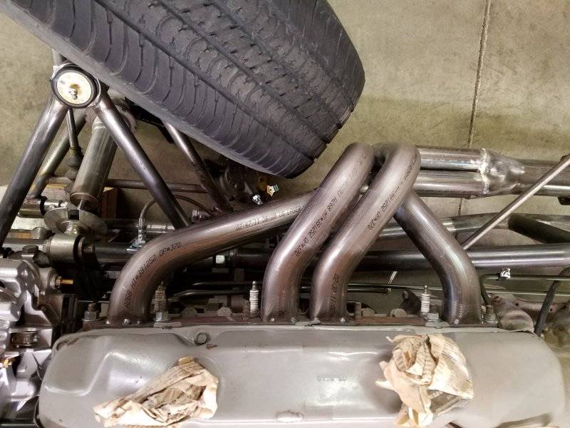

Custom on mine, but a special
application. Paid $300.00 for the
set.
Flanges and mufflers were not
included in that price.
