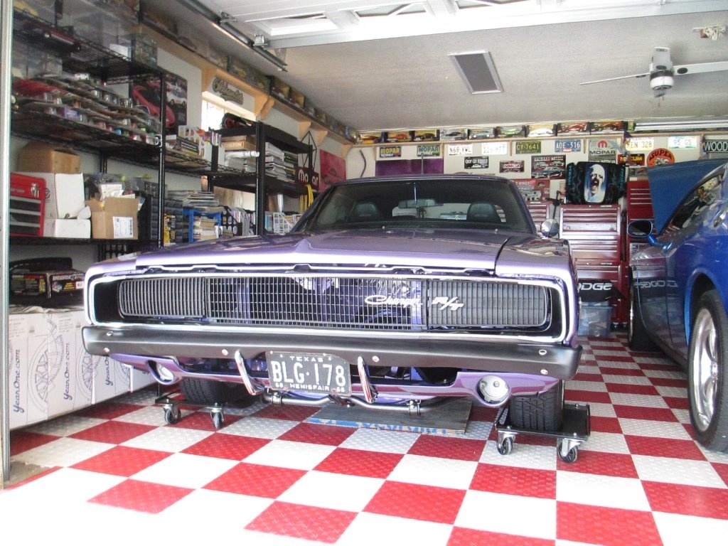

1968 Charger "Master Charger" RestoMod

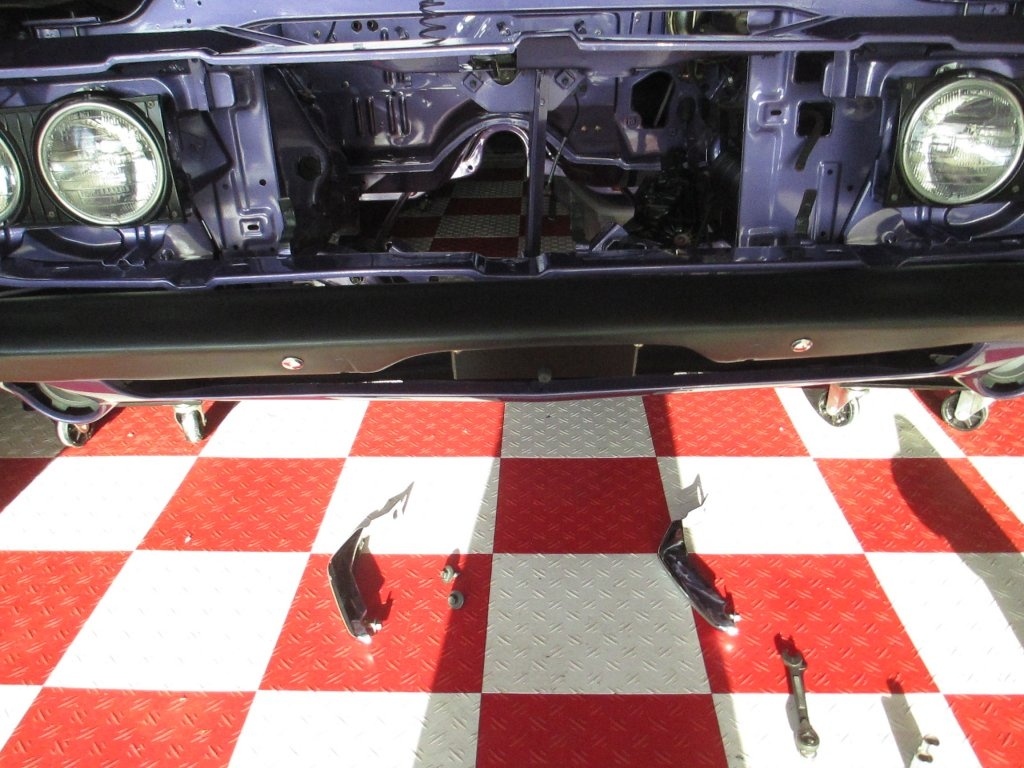

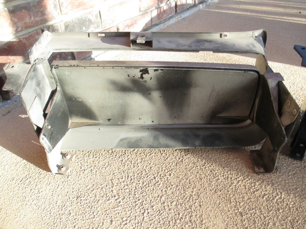

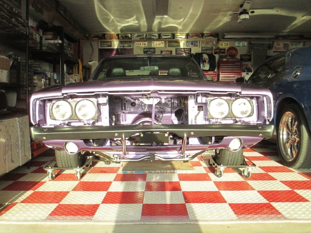

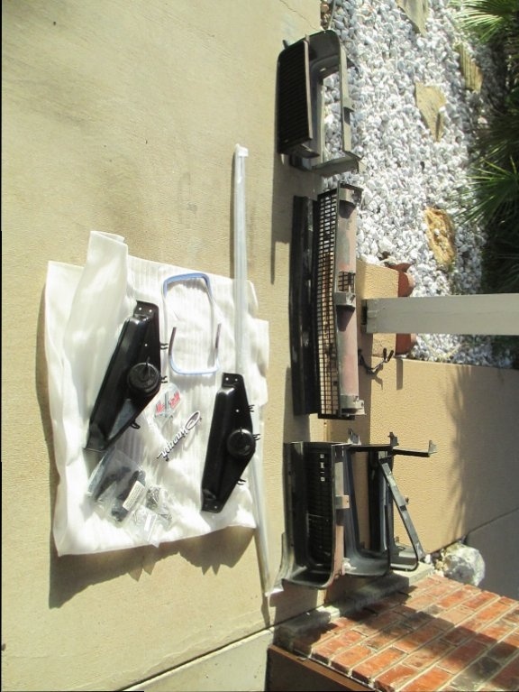

Grill supposed to arrive today, prepping everything else making sure I have all other pieces so have a mix of old and new with the old grill out as well.
IMG_5919.JPG IMG_5920.JPG IMG_5921.JPG IMG_5922.JPG IMG_5923.JPG IMG_5924.JPG IMG_5925.JPG

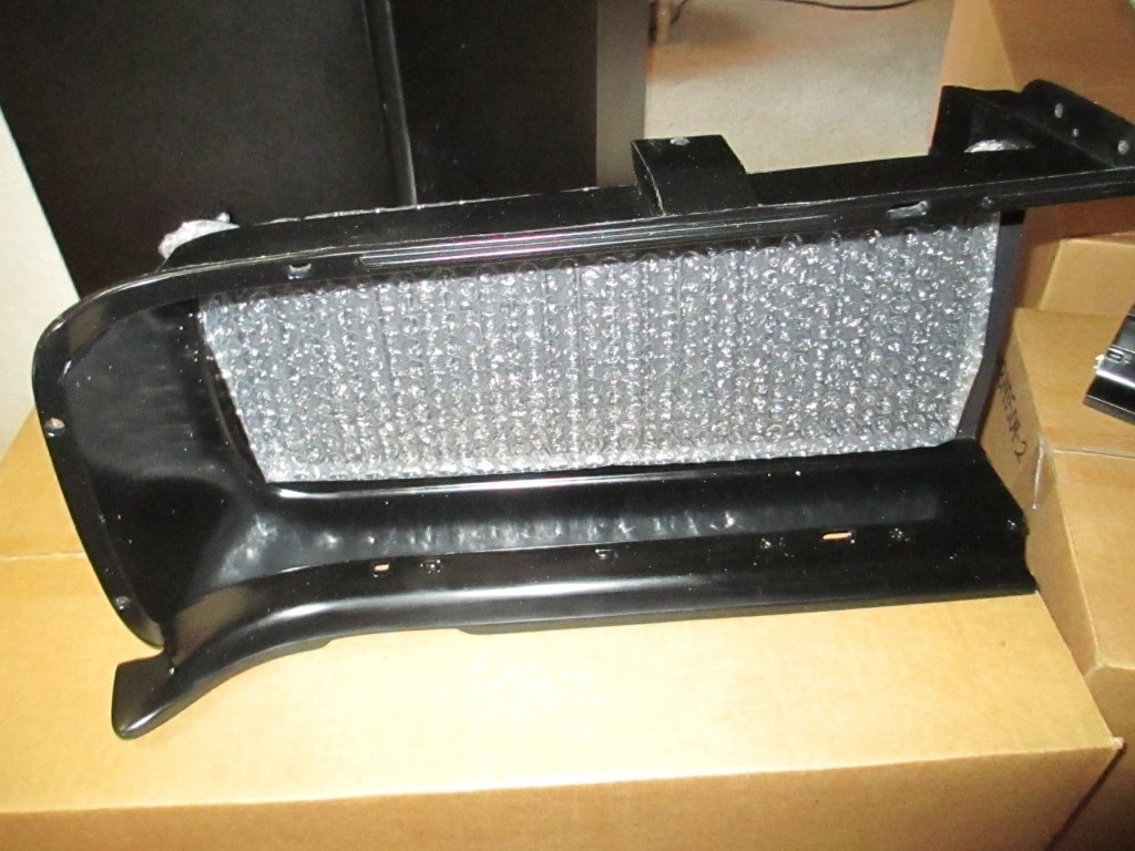

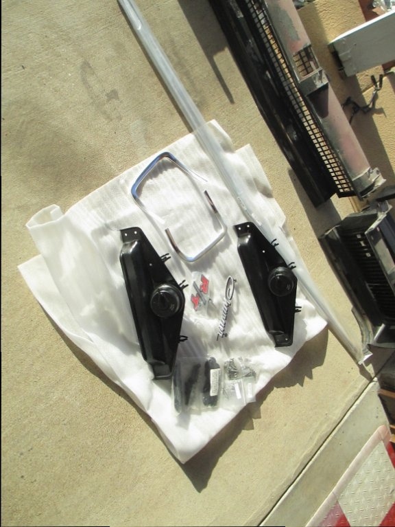

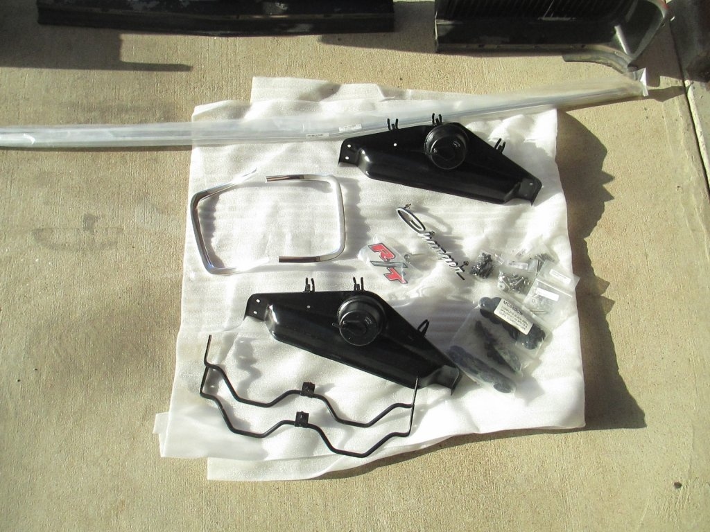

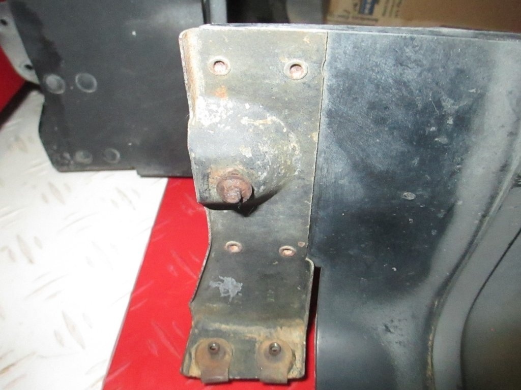

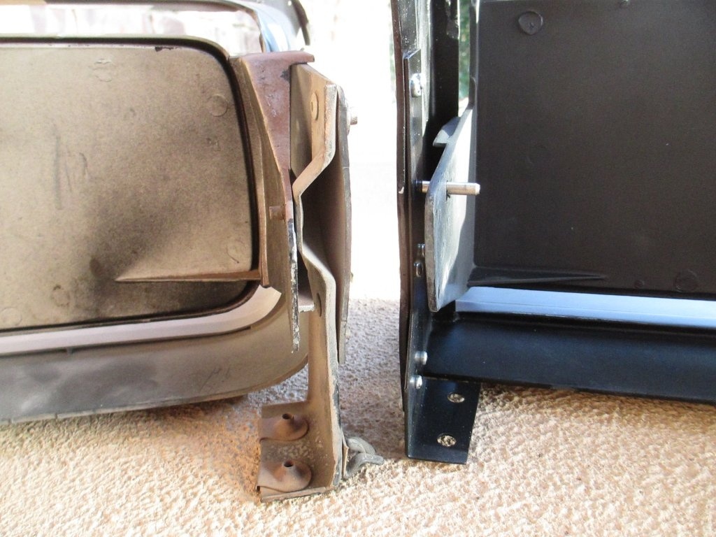

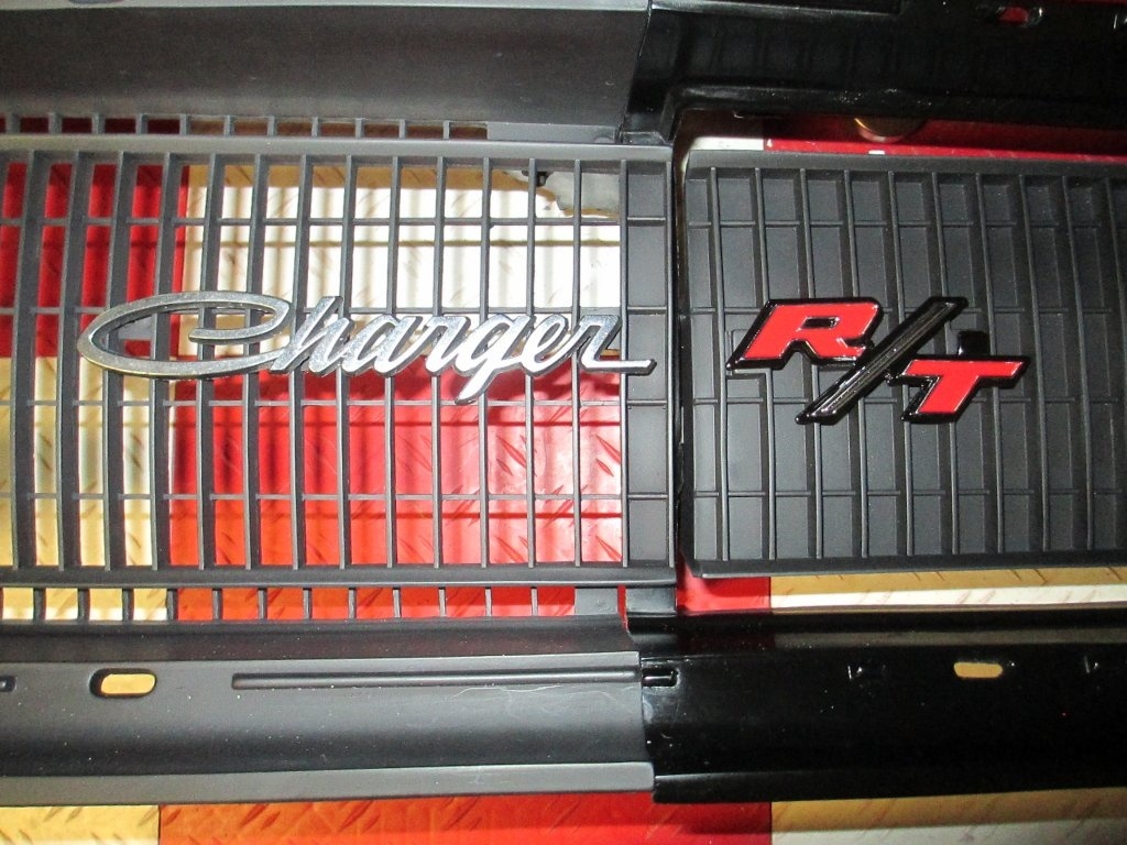

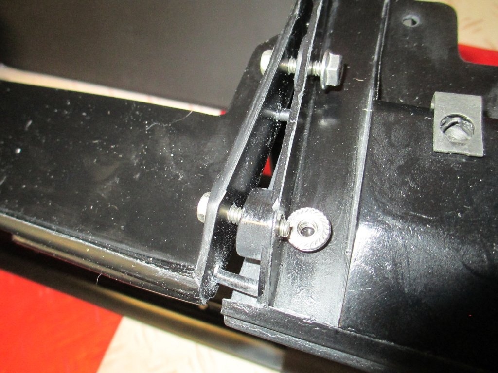

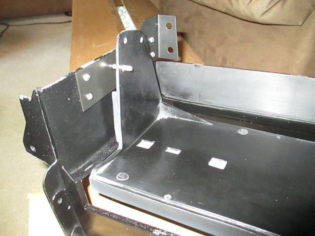

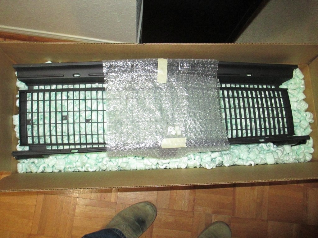

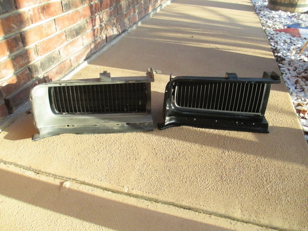

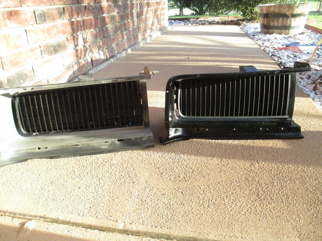

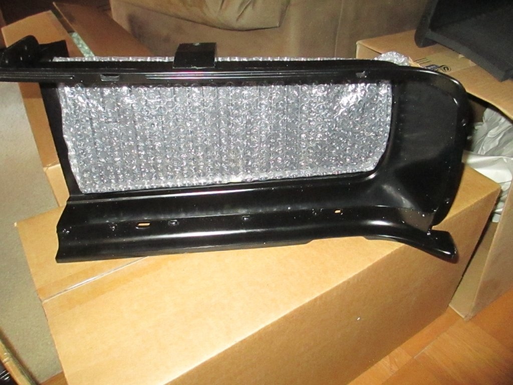

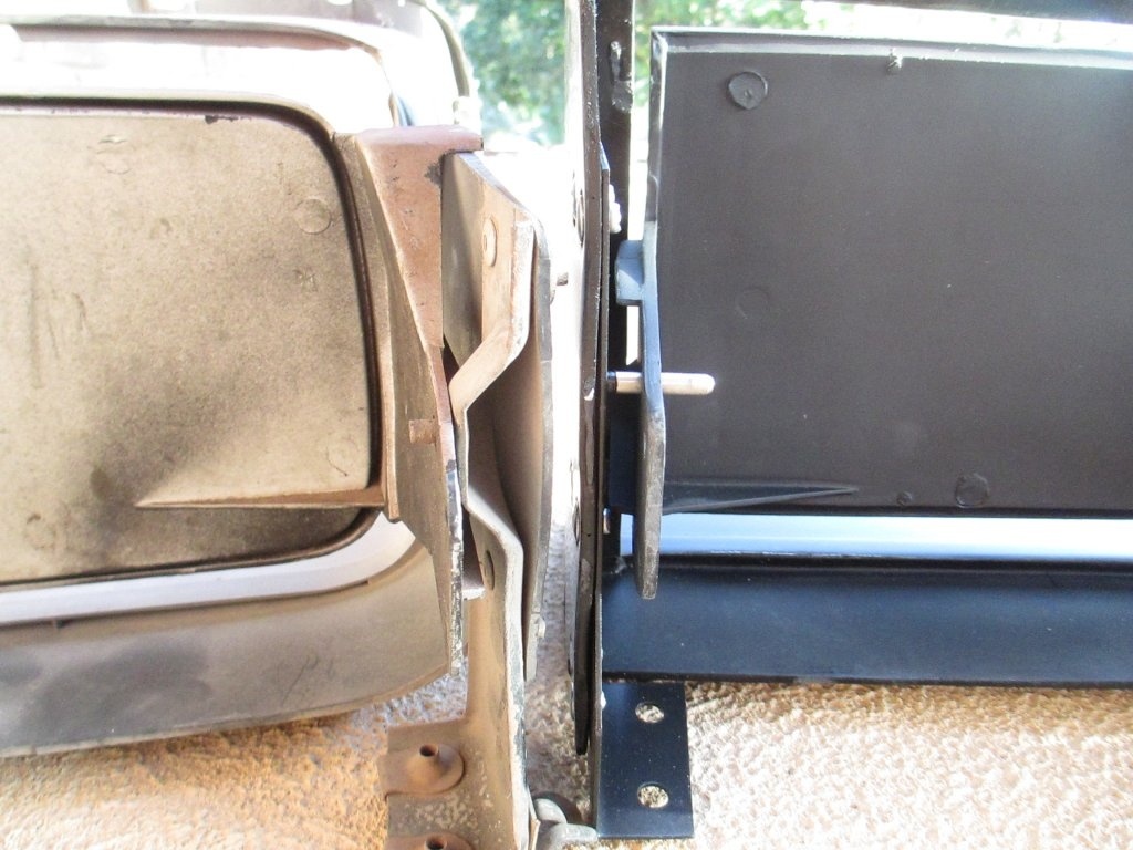

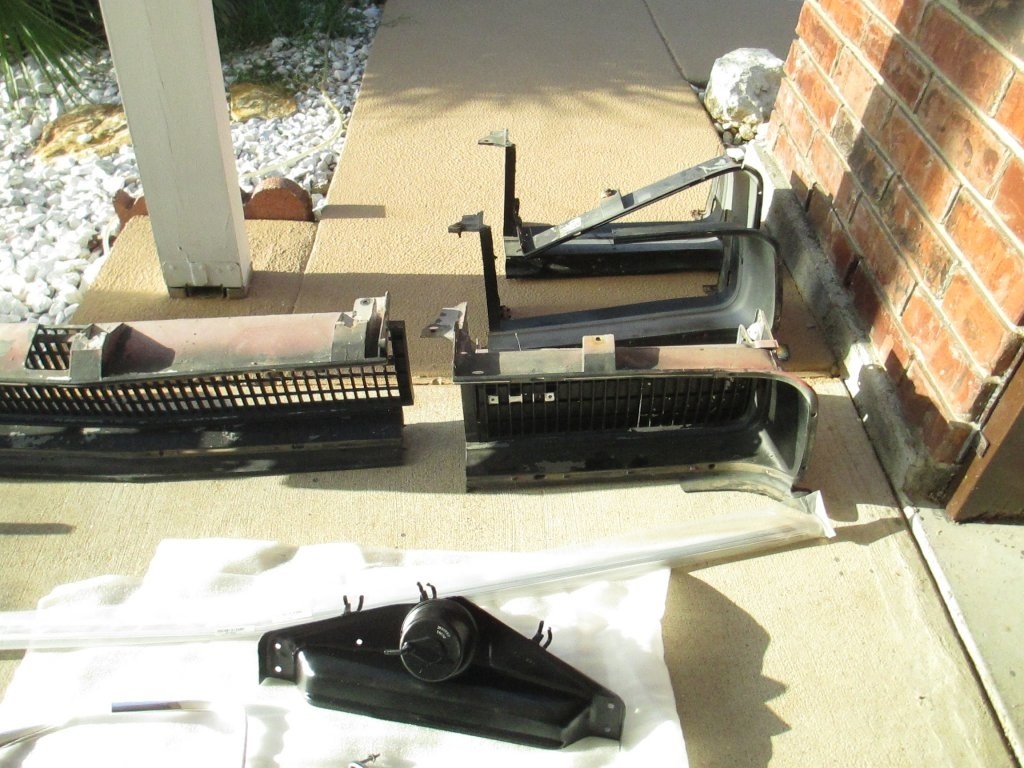

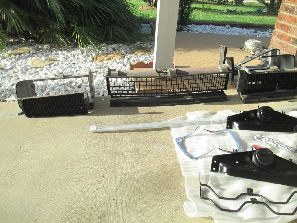

2 O'clock delivery turned into 630 so just finished unboxing the new Grille from Classic Industries. Came in 2 shipping boxes with each piece in it's own box as well. A lot of Popcorn protecting them. first thing you notice is the dark color and heavier feel, held both next to each other and a few differences but overall an improvement. its a little thicker and you are not afraid to actually handle them. The headlight covers brackets are one big change as the stock bracket was a bent style and the new ones are flat with longer studs.
IMG_5926.JPG IMG_5927.JPG IMG_5928.JPG IMG_5929.JPG IMG_5930.JPG IMG_5932.JPG IMG_5933.JPG IMG_5934.JPG IMG_5935.JPG IMG_5936.JPG
There is Slack and with heat sure to warp and pop off if someone forgets to use the nut to secure them. I will post once everything is installed if there an issue. so far actually impressed with the pressing.

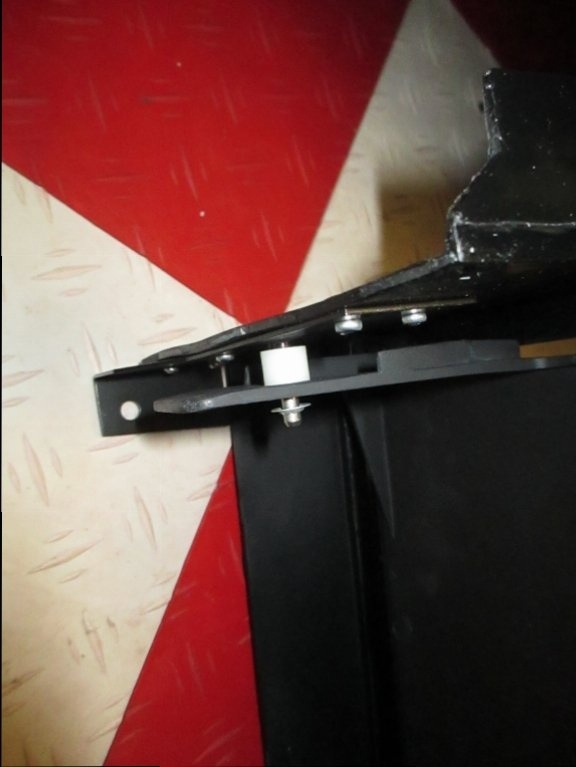

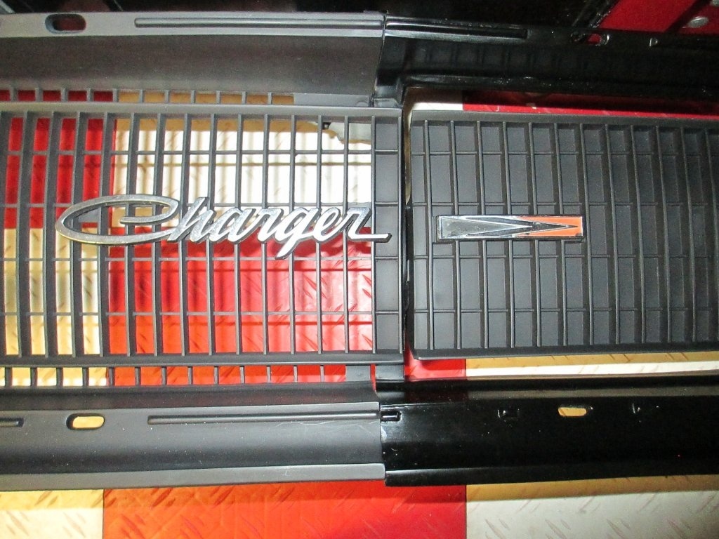

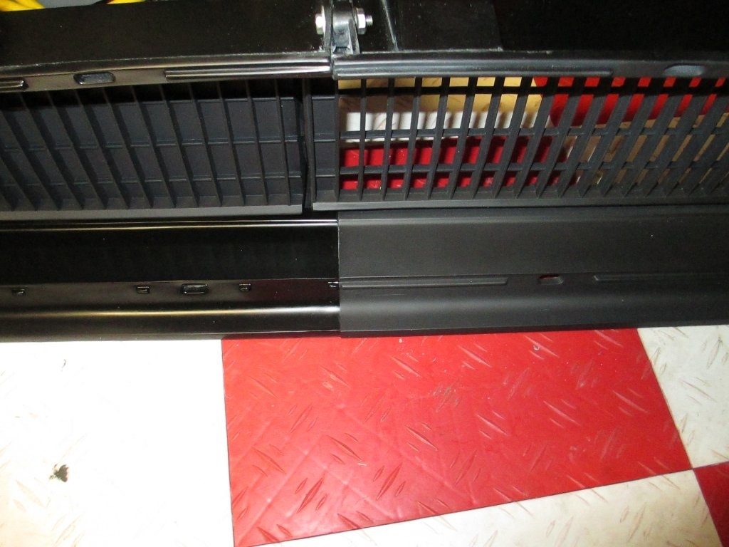

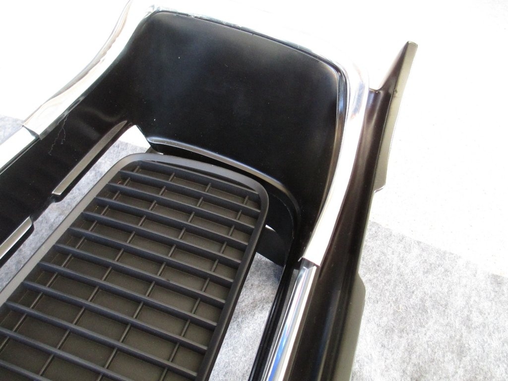

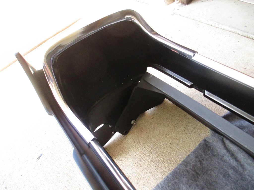

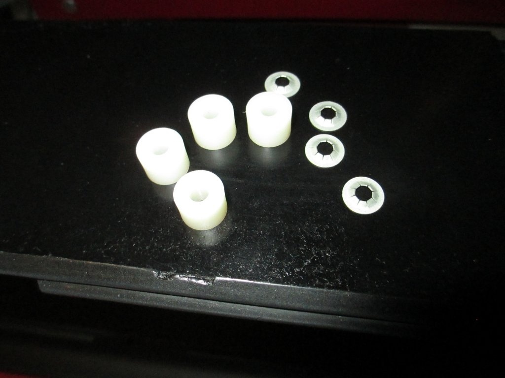

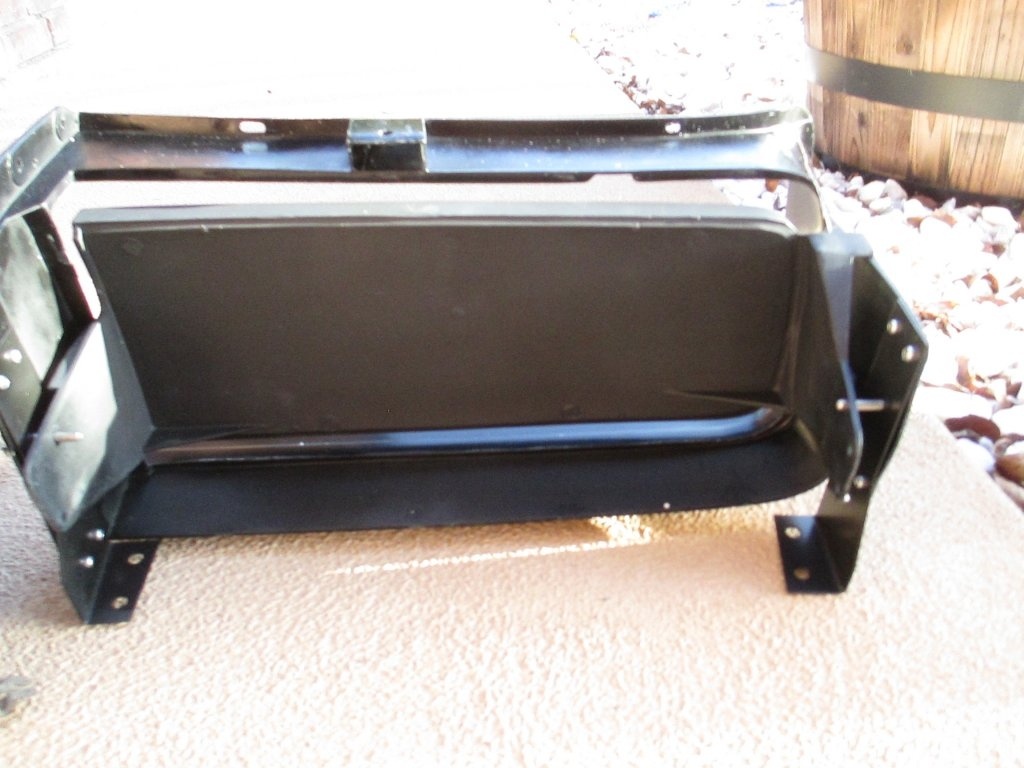

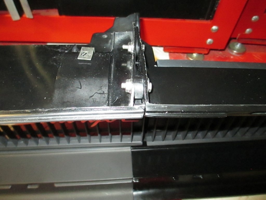

Putting together and here is where things get interesting. comes with bushings and clips to give the doors clearance and tighter fit. when mating the buckets to the center piece, the alignment holes were too small so used a small bit to widen up for fit, the grille doesn't mesh up in some areas and has to be wrestled into place. then the big Oh F### moment came the color shade are way off. put both badges on and looks good either way and fits excellent.
IMG_5940.JPG IMG_5941.JPG IMG_5942.JPG IMG_5943.JPG IMG_5944.JPG IMG_5945.JPG IMG_5946.JPG

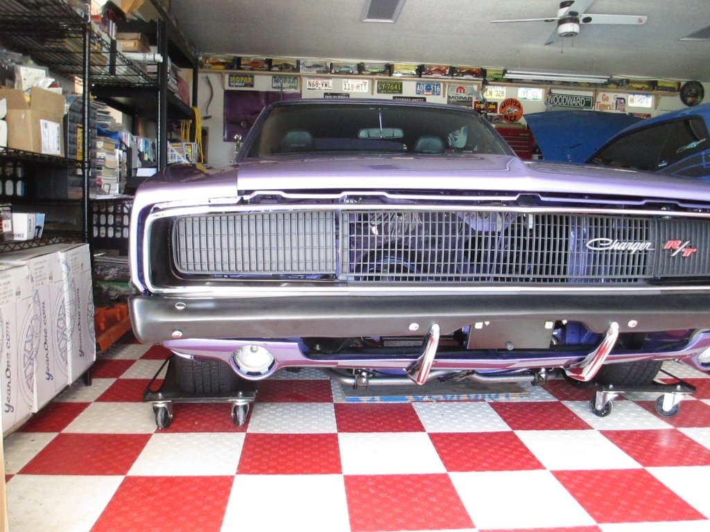

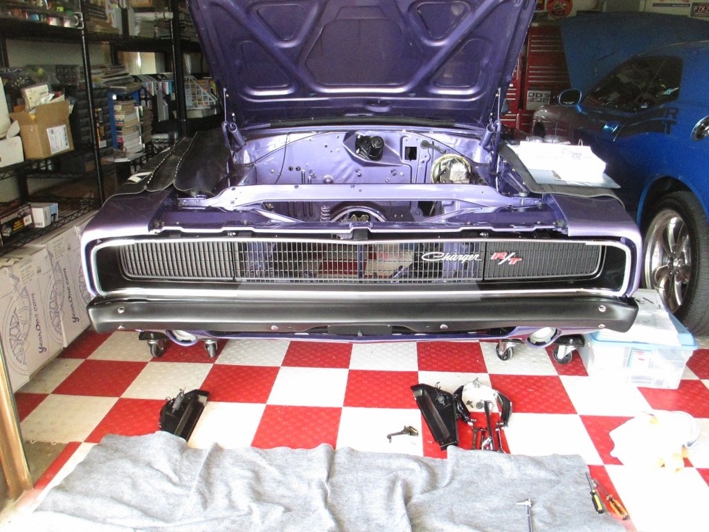

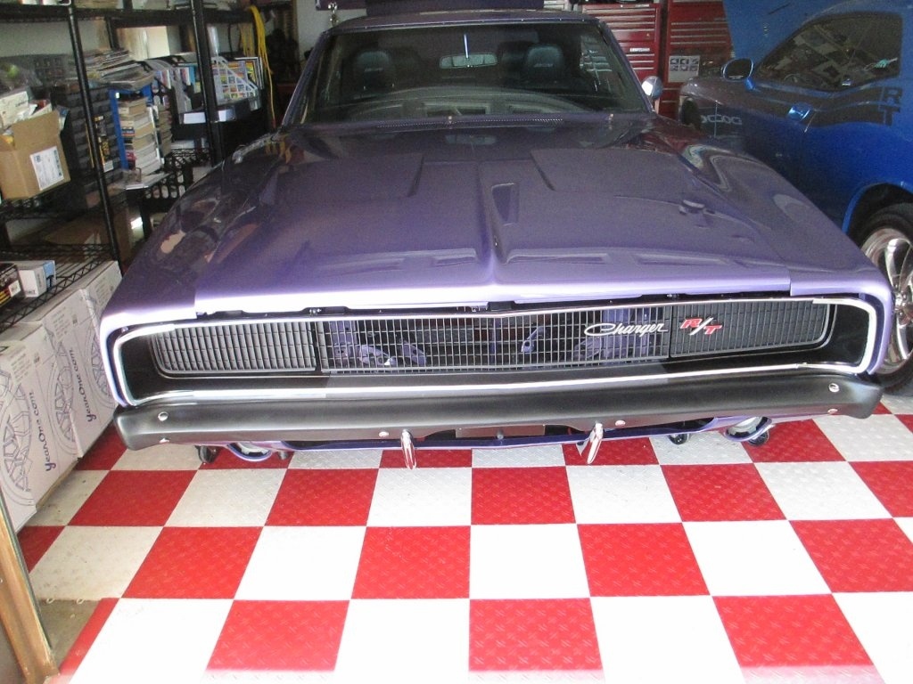

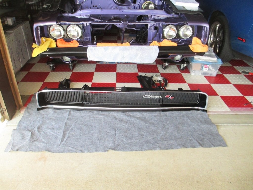

ready to go in, only issue so far has been alignment with new chrome trim made in Taiwan. doesn't line up and fall into place. tested it with the old trim and fits correctly so would've been better off trying to refinish old pieces.

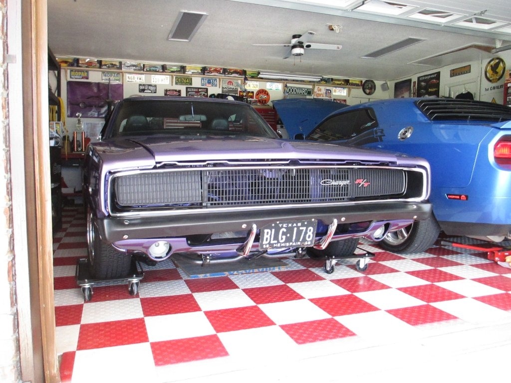

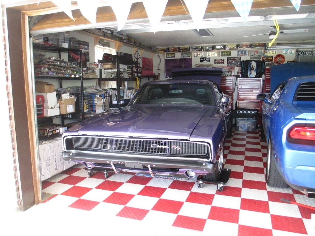

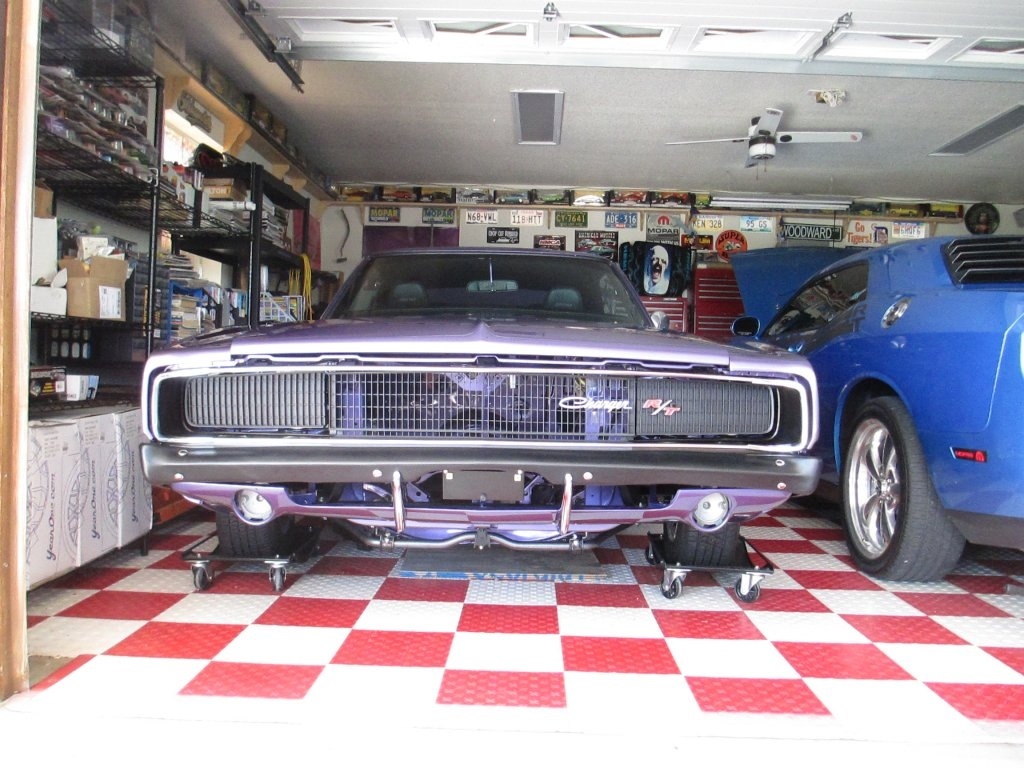

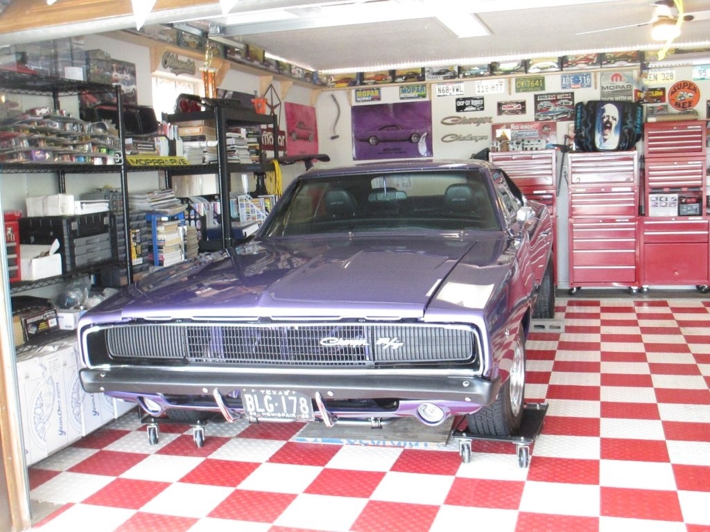

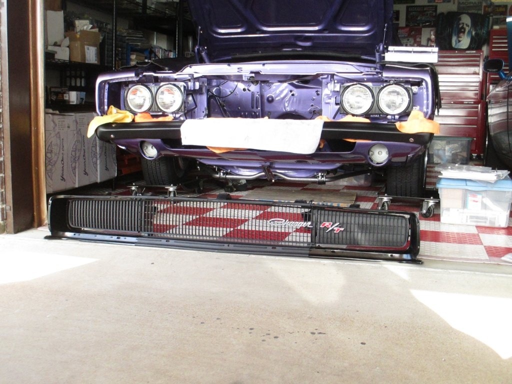

installed and no problems with cover clearance. gapping is off so going to loosen up fenders and front and get a better fit to everything, also next time remember to do the arms for cover out of vehicle as had issues install some of the screws. but overall a better look than before as the grille was cut out for bumper style towbars. next is to install Halo lights and LED front signals as the sides and rear are already LED

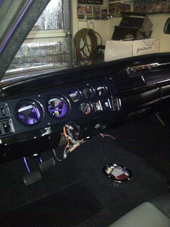

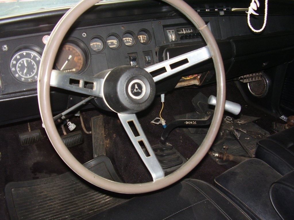

working on the dash and comparing gap before I install the gages.

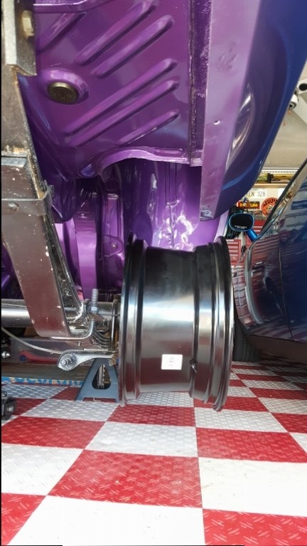

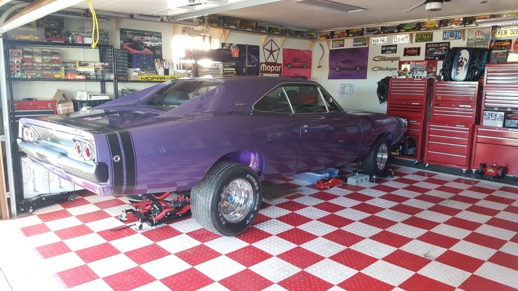

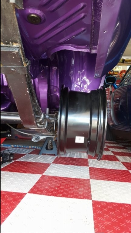

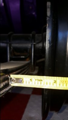

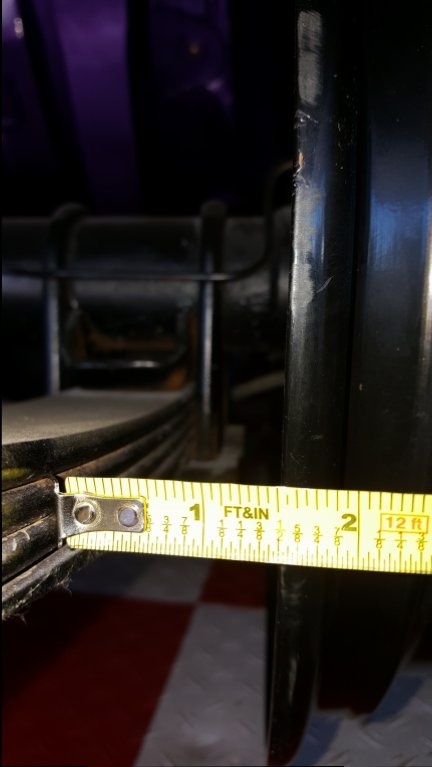

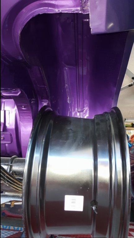

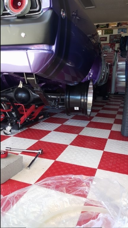

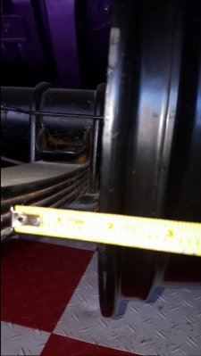

changing out the Tire and Rim combo. going from 15 x10 Cragers SST to 17 x 10 Magnums. making sure the measurements are correct for the size tires I can fit without rubbing
20161201_121512.jpg 20161201_121407.jpg 20161201_121415.jpg 20161201_121426.jpg 20161201_121504.jpg 20161130_150507.jpg 20161201_121355.jpg

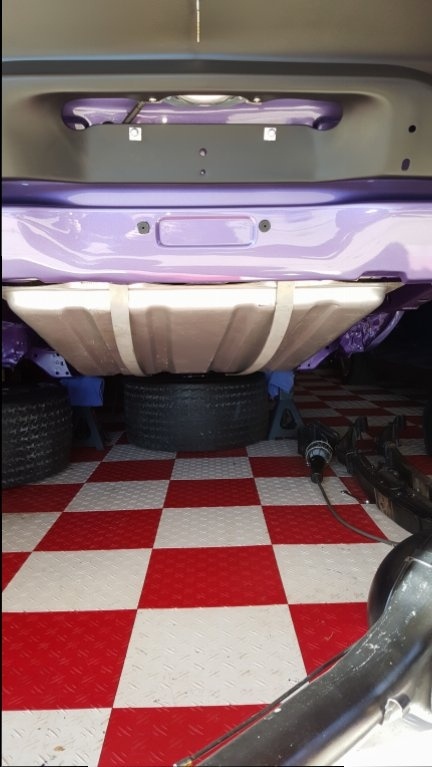

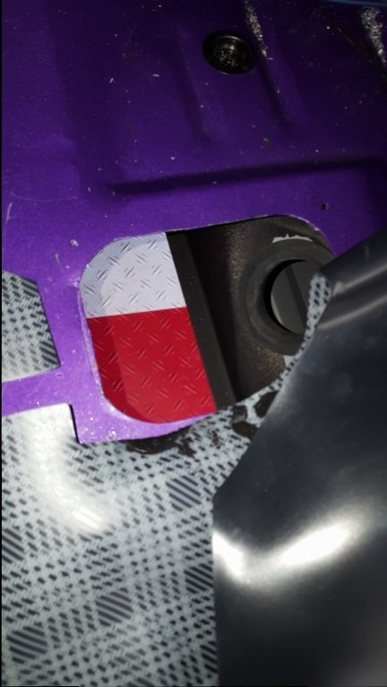

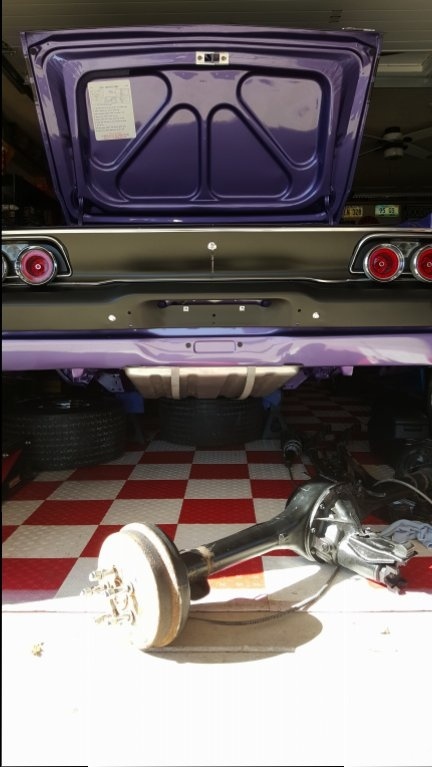

finally found someone to weld fuel tank brackets and repaint undercarriage, today Installed fuel tank into place can now I can work on the suspension and fuel lines.
