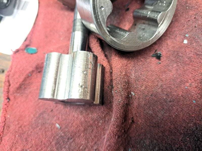

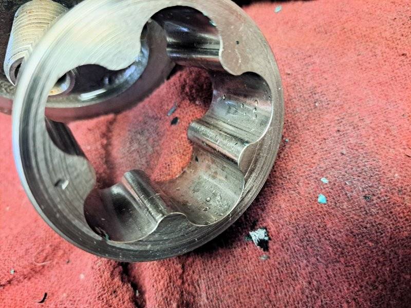

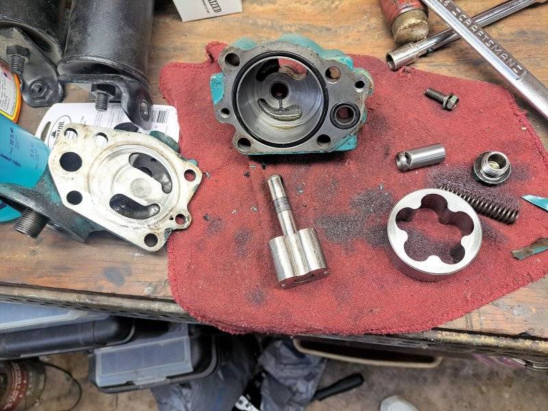

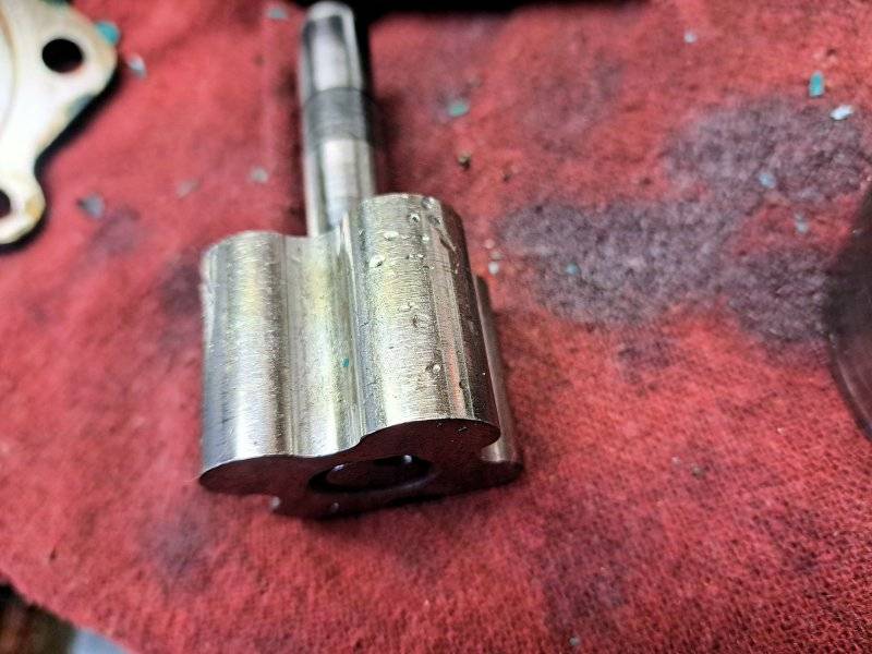

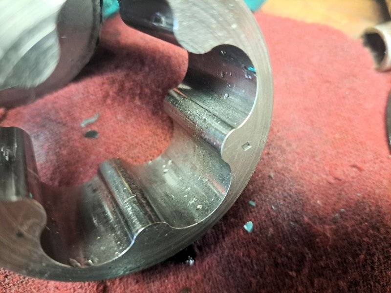

I pulled the pump, opened her up and found a few things. The bypass valve seems to be moving freely inside the bore. I removed it, cleaned it and the bore itself. Both o-ring seals are pretty flat so that isn't helping. The worst thing I found were a ton of scoring on both gears. I'm posting pictures for reference. I'm going to order a new pump on Summit. I'm not sure if I should get the Melling DODGE Melling M63HV Melling High-Volume Oil Pumps | Summit Racing
or the Mahle DODGE MAHLE Original 601-1029 Mahle Original Oil Pumps | Summit Racing. The Mahle is triple the price, and the Melling has very good reviews so I'm thinking that's the way to go.
That pump sure ate some stuff! Wouldn't be a bad idea to clean out the pan and pickup.

You pump has ate some metal and that has probably cause your bypass valve to stick.
I would for sure be dropping the pan to inspect for contamination.
I just spoke to a local engine builder that I've known for 40 years. I sent him the pictures and he didn't like the looks of the pump internals either. He recommended replacing my pump, but said I definitely do NOT want the HV, I should get the Melling M-63 which is the standard volume pump. I just ordered it from Summit with a new gasket set. Summit usually delivers to me within 2 days at most, so I'll update when I get the new pump installed.
