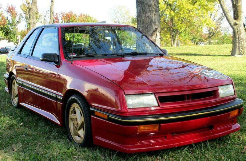

If you want a truly RED-red, Chrysler had one in the late 80s called Exotic Red. PR1 was the paint code, I believe. It was the OEM color on the 1989 Shelby Dodge CSX-VNT:
ncdn.azureedge.net%2Fstaging%2Fcarlist%2Fitems%2FFullsize%2FCars%2F137693%2F137693_Front_3-4_Web.jpg
I've owned a couple of these cars, and they are R-E-D. Not undercooked-steak blue, not orange...but fire engine, blood red. If you're going to do the "flow the touchup paint" method mentioned above, hit up a NAPA or Autozone and see if they can order you a bottle of the Exotic Red. I think you'll be happy with it.

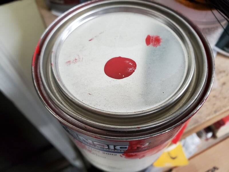

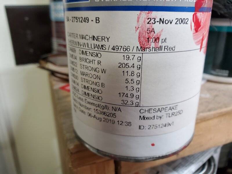

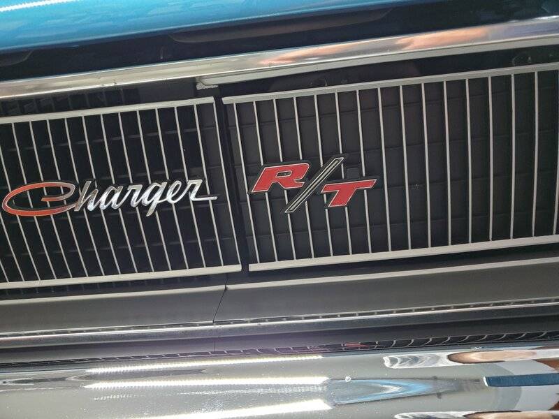

I'm sorry I didn't get back to you with the paint code that I used. It totally slipped my feeble mind.
Anyway, here it. It's not a deep red, but it matched some of my older emblems after I cleaned them and buffed them out.
Sounds like you might have found color you were looking for.
