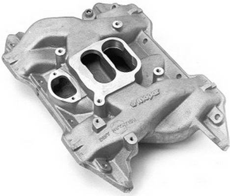

There is a Mopar Performance M1 intake Manifold P4529117 it looks the same as the original intake on the outside, it has the same height, it's made of aluminum and it has an operating range up to 5800 RPM
It's no longer produced but you could possibly find one for sale.
Thank you, Orig. I was hoping to use the intake the owner already has and just update the carb to use an electric choke...just not sure if that will be possible.
Thanks again, Orig69. I spoke with the owner of the car this afternoon and he has decided to sell the CH4B intake manifold. We will purchase either an intake like you shared or a Performer 440, so he can retain the original carburetor.
