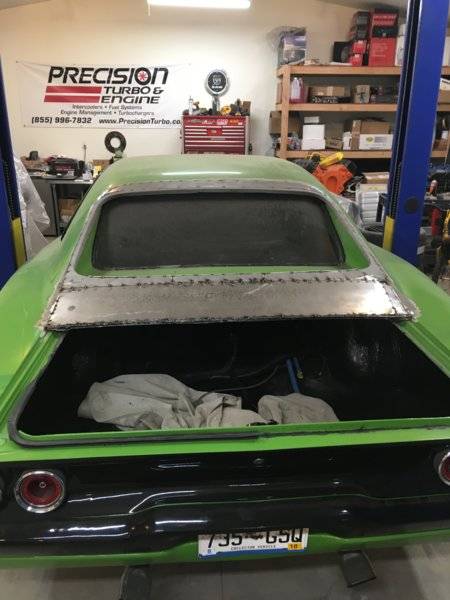

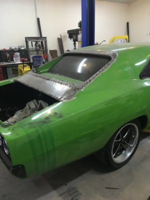

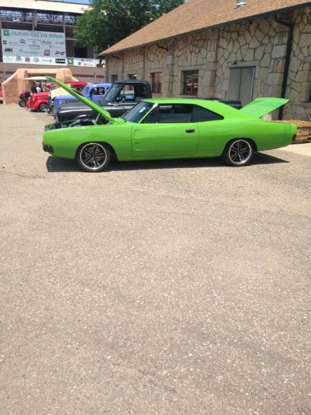

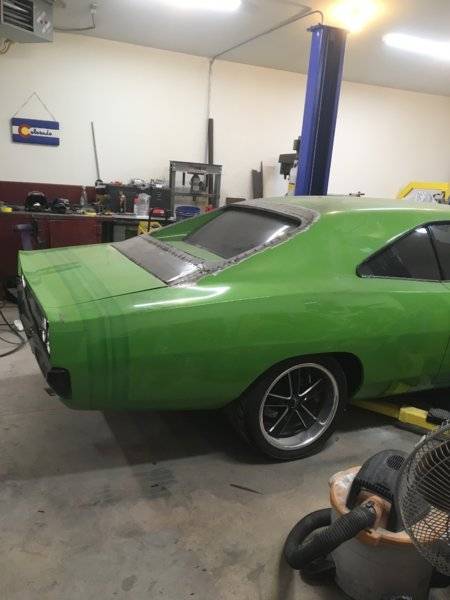

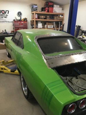

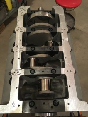

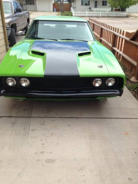

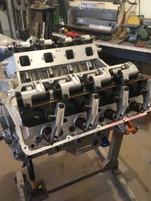

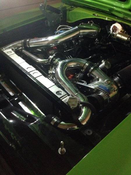

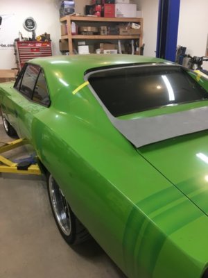

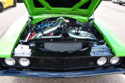

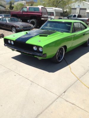

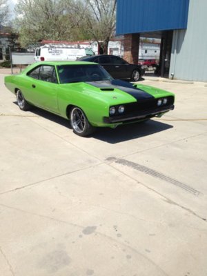

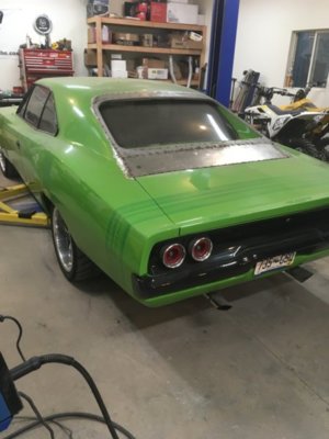

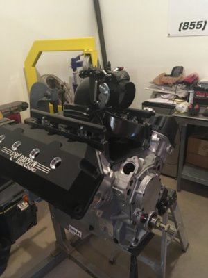

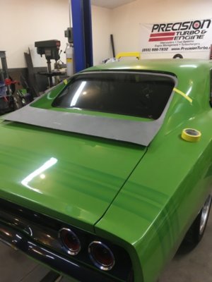

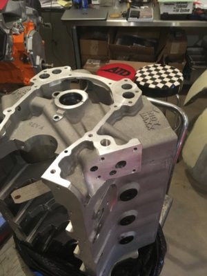

I am getting ready to start on my Twin Turbo build and I'm going to finish the 500 conversion.
I built this through out the last 14 years and raced it for the last few years.
I made the mistake that All of us make.I took the engine out to add more power and thought I would have it back together in a couple of months change my mind a dozen times and well that was a year ago. So now I am starting back on the car between finishing some other projects. I just pulled the car out of mothballs and put it back in the garage yesterday. More pics to come but I'll start with what the car was before I took it apart.
Thanks,Joe
IMG_0425.JPG IMG_0426.JPG IMG_0428.JPG IMG_0506.JPG IMG_0508.JPG 13403294_1089392261119578_8075905252371957713_o.jpg IMG_0668_2.jpg 2017-heuberger-subaru-pikes-peak-airstrip-attack-recap-216705-1.jpg DSC_0386.jpg DSC_0293.jpg
Hey what are you gonna do with the old procharger stuff?
I sold the drivetrain to a friend of mine. He has a 1969 Dodge Charger he bought the Procharger as well.

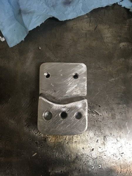

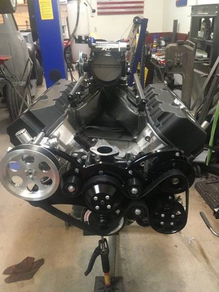

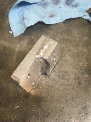

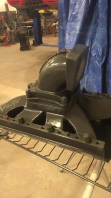

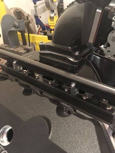

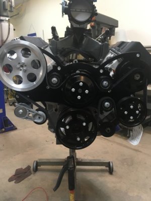

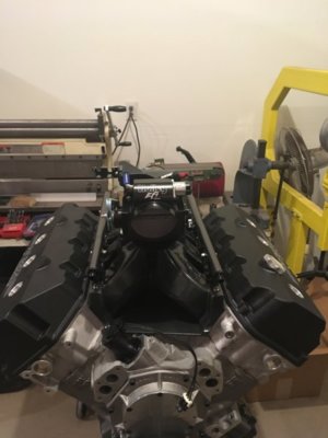

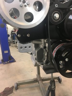

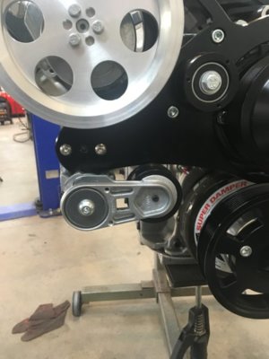

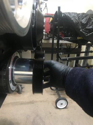

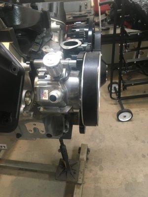

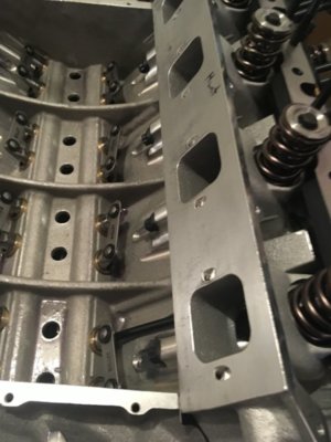

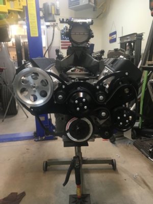

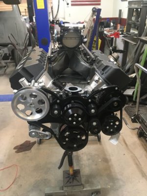

Mocked up the CVF racing serpentine system. Changed the A/C location to a GZMotorsports air pump. Was able to do it without modifying the main brackets. Made a lowering adapter for the tensioner and had the 8 rib pulley made for the pump.
150C3959-89F2-42CA-82B5-210162682E15.jpeg 3AB0BA84-0E27-4F72-842C-27F8321B1C8C.jpeg 58AC9B98-C073-4884-A685-E88A5945F341.jpeg 161407D5-1354-4FCC-A978-0A2043497FCE.jpeg 2F81878B-A2B1-4739-934C-845547134849.jpeg 48ADB7ED-EA01-46D6-81F1-ED87B5F51E70.jpeg 86B47EA3-9C63-4B14-8A3C-6BACD519DCFE.jpeg 606270D1-5833-4099-B348-CFA58CE128A8.jpeg E39B1AD4-8565-4E1B-8D01-8FDFB2875DEF.jpeg B708CB34-8B4B-4008-AEE8-35F0A6DEDDDD.jpeg
Absolutely. It would need to be below the tensioner pulley or move that and put the pump there. It’s all doable.
I agree it's doable. The spacer off the back of the main bracket to line up the Gz motorsports pump are 3/4". If you use a serpentine system that is 6-rib you can just buy that pulley from GZMotorsports.
