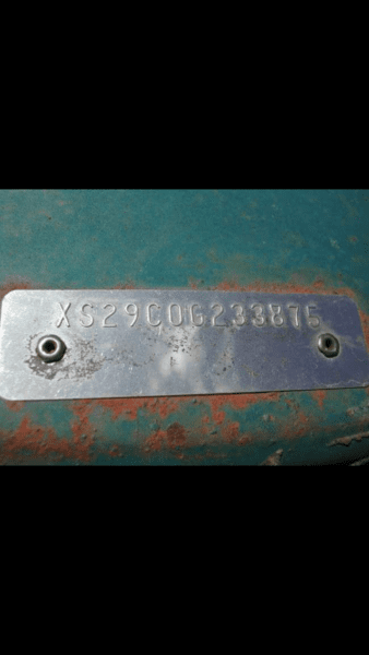

Anyone found this one? The picture was sent to me by a friend. I have no other information.
C is 225, B is 198
5th digit
I don't see them putting a 198 in a Charger, though
Standard engine was either the slant 6 or 318 2 bbl. for the 68 model year.
91 r/t was a little quicker on the draw:thumbsup:
XS being an R/T with a 6 cylinder? I think that was a restamp maybe?

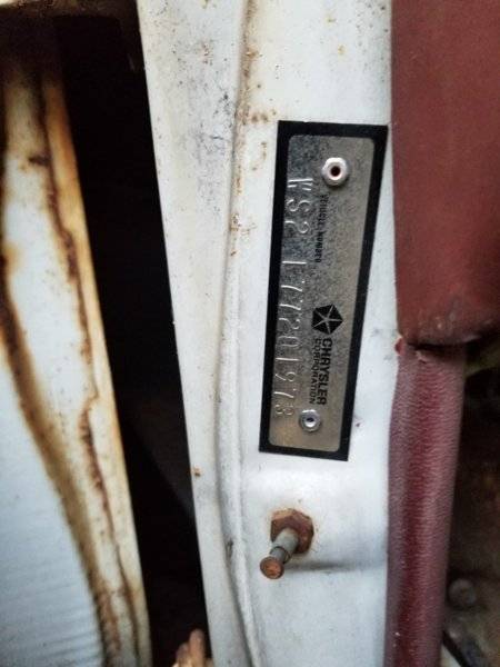

Chrysler did make mistakes on VIN tags and car builds. Here is another VIN error. I owned this one for a while.
Chrysler did make mistakes on VIN tags and car builds. Here is another VIN error. I owned this one for a while. View attachment 763345
Oh yea I get that. Just usually when there is no black paint and other stuff maybe it is a restamp. Most VIN's that are completely bare and altered didn't get that way naturally. Some but not most. Either or a wierd car for sure.

XS and C not factory build
I can't say anything about the XS 70 Charger as I didn't take the picture or see the car. There does seem to be some remnants of black paint and the rivets look real. Proof is in seeing and I can't claim that. It is just one of those unanswered questions. My friend that sent this to me is in the same boat, he doesn't know more either.
Our questionable member 442 bought the 67 Coronet R/T from me that was missing the 3 in its VIN #. That's probably where the disputed R/T inside door emblems came from, but I can't say that for sure either.
Fender tag should show a "E" code for that Charger.
I passed on buying a 69 Coronet R/T that had transposed VIN digits on the block.
I'm sure it came that way from the factory, and the seller claimed he was discounting the price accordingly. On a 20K plus car (at the time), I'd personally rather buy a "real" R/T without the matching number engine for a LOT less.

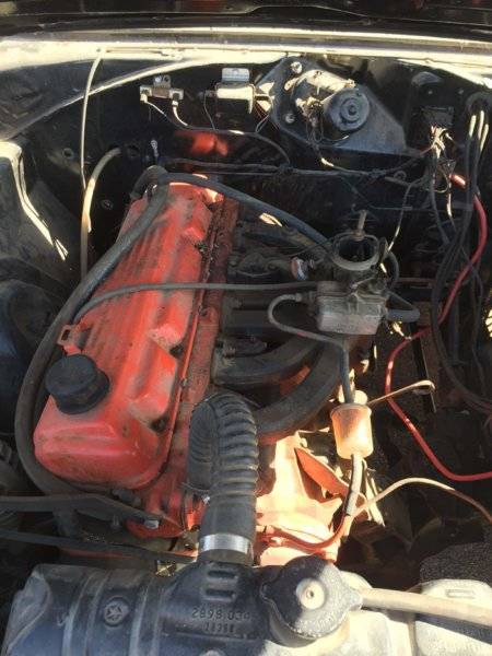

There's a 68 in Ocala with a six. 6 cyl b5 blue automatic car.
A slant six is rare in a 68-70 charger for a very good reason.........
