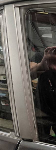

Pic with window up. You can see it pushing pretty hard on the bottom there.

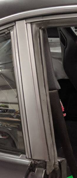

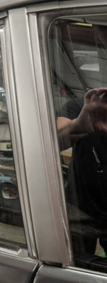

One thing somebody mentioned was if things look proper in my image in the first place. I am currently trying to find pics/videos of the car as it was. The car has new doors and all kinds of work done. So i'm looking at walk-around super bee / 440 post videos and at pics to try to see if something is off.
Do you guys see anything off in my posted picture? or does it look correct?
thanks
Too busy to do a good post with photos right now but with investigation we figured some things out. 440/Bee workarounds I saw that the seal is quite different. So what we did was adjust everything a bit like the glass placement etc... overall adjustments. but the big one i think is gluing the "rear roll" back. basically "tucking it". Which may be using the window for a long time would kinda do itself anyways. The glass was running along that roll but its not supposed to. Its supposed to meet it at full closed but not run on it. Now we have it working much better/smoother by tucking/gluing/rolling that part back.
