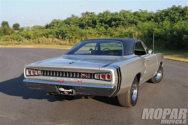

Hi,
Somebody here with a 1968 Coronet R/T or 500 who could help me out and measure the spaces between the "D O D G E" letters on the rear of the vehicle?
See on the pic below:
Measurement A: The space between the letters (edge to edge)
Measurement B: Length from bottom edge of letter to the horizontal body line
Thanks in advance!!!
I made a drilling template for someone a few years ago but did not save a copy..... So
D -> O = 3.825"
O - > D = 3.785
D -> G = 3.670"
G -> E = 3.785"
Bottom to body line = 0.775"
From an original factory 500.
Converting to Metric is left as an exercise for the reader ;)
