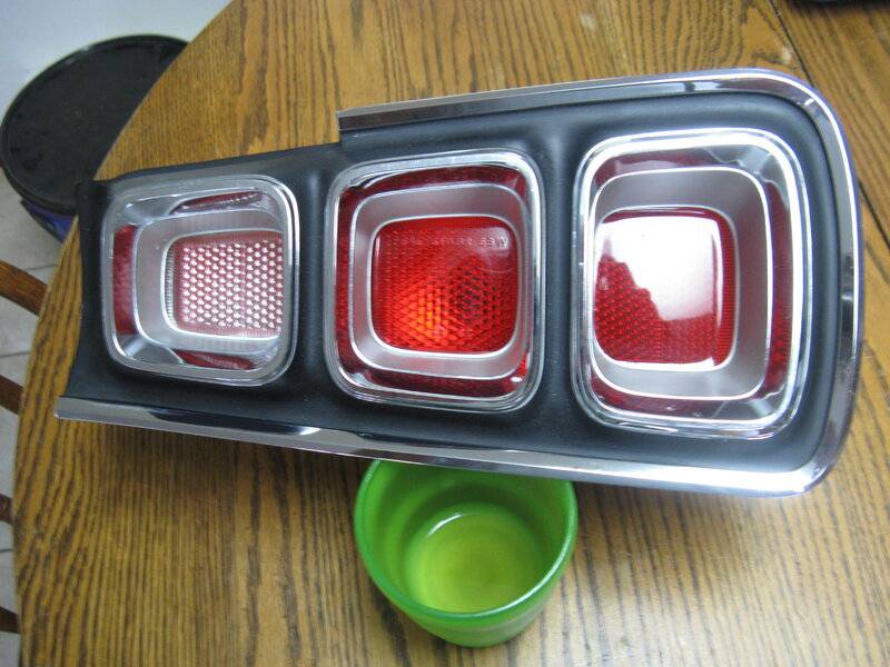

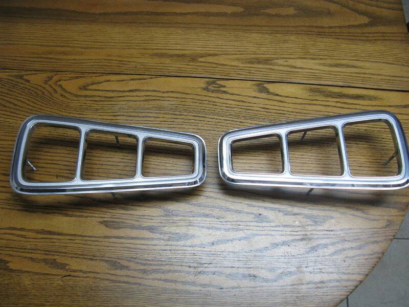

@Dodge33 Your mailbox is full so I could not contact you but this may help others too who don't know there are 2 different pieces of trim for the decklid of a '68. The trim that was for sale in the exterior parts for sale is not correct for a 500 or R/T. The Coronet and Super Bee have a molded line in the taillight bezel that the decklid trim also has where the R/T and 500 is smooth... Here is an Nos set of 68 Coronet Super Bee Tail light bezels(sold already) and an Nos 68 R/T 500 taillight so you can see what I am referring to...

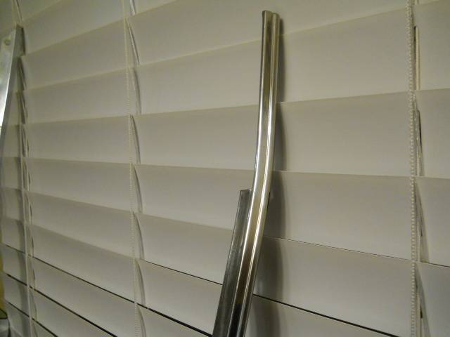

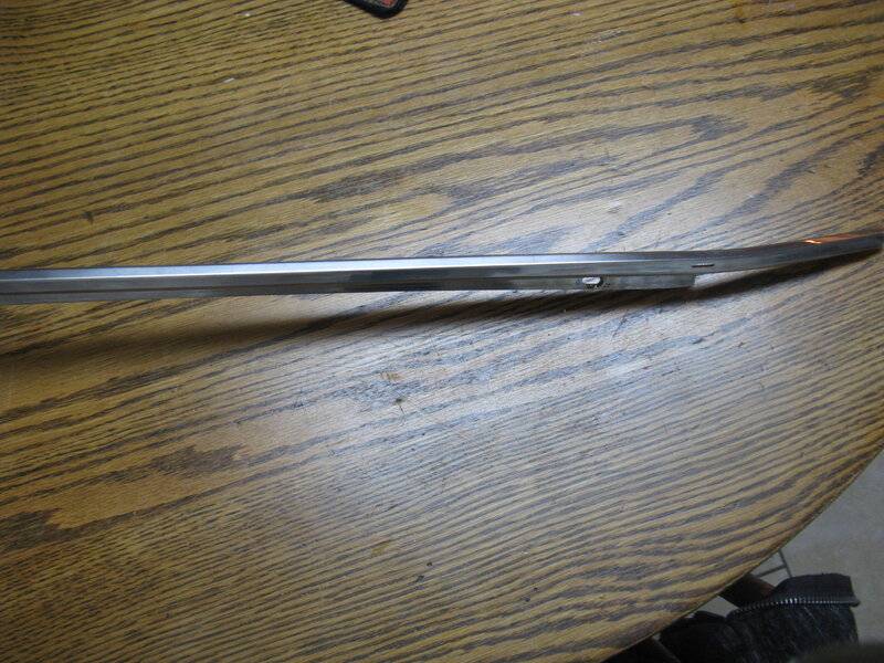

A R/T or 500 Decklid Molding..

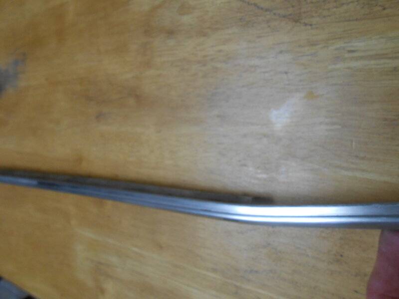

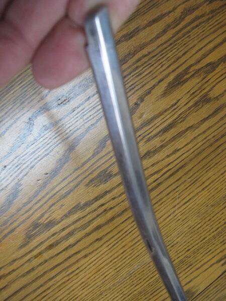

The 68 Coronet and Super Bee Decklid molding..

Your welcome and now you will have 3.... It's not smooth and you can see the molded line in it on the ad...
