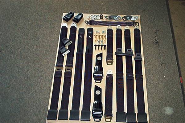

Can someone please post individual pictures of what the belts for the front driver and passenger should look like/where they should connect? I have some belts but I am not sure if they are for the front or back, or even passenger/driver. I also do not see an upper anchor bolt so I presume this car only came with 2 pt lap belts and no 3 pt.
FYI - Front lap belts with have flat mounting plates....rear lap belts will have an angle bent in the mounting plate. Here is a photo of everything needed for an install with shoulder belts. front lap belts are on far left, then shoulder belts, front retractors, and the entire rear set on right side of photo.
