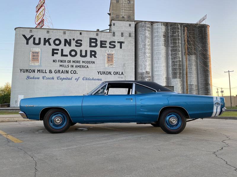

I have a 68 Hemi bee, automatic transmission so the question is, "Does the transmission neutral safety switch have a single bolt with nut, or does it have a three-prong type? Also, the wiring harness for automatic vs 4 speed is different?
